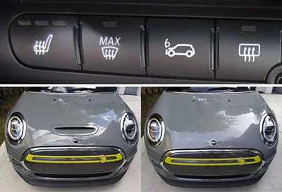

I was so lucky to get the hood-scoop eject button in my SE! It filled out the switch complement and got rid of the skeuomorphic fake hood ornament. However, it's a one-time-use button, so it works only the first time you press it.
That button could be $2000 button proposition to do right and if I’m tired with hood scup I fill with quart of
Bondo to eliminate a fake crab for $20 and a lot of sending .
Getting a scoopless base F56 hood, having it painted and installed cost me about $1,600 after selling the original hood for a mere $200. I first tried selling it on eBay for $1, not including shipping, but no takers.
I was right that scooples hood with a button to replace is almost $2000

I'm just a Photoshop amateur, there is no sticker on that button.

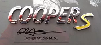

I did, however, make one sticker for my SE. When MINI's head of design, Oliver Heilmer, responded to my 2019 letter begging for a hood-scoop delete option, he replied he would take up my request with Marketing. In those few words--along with no concept drawings or concept cars or SE prototypes having a hood scoop (see my website)--he let me know he agreed with my negative opinion regarding a fake hood scoop on an electric car. So I purloined the signature from his letter and made a sticker design to indicate my SE is an Oliver Heilmer Signature Edition SE, unsullied by the bullies in Marketing.
I think this is a great designer-worthy signature (I can identify one letter, the "O" in Oliver, because it comes first).

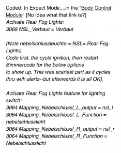

I got an OEM switch module off Amazon for ~$150. It pops in with about two minutes of effort, plus the amount of time it takes to code the changes in Expert Mode.

Oh, if you have details on this I'd love it. I did a lot of research into knowing what needed to be done, but didn't think it would be easy to replace the switch. I know it's basically just a matter of getting the right switch, and then coding the rear fog button and the rear fog dash indicator.

I looked into the the useless rear fogs when I had my 2019, I never got around to doing it but it should still hold true for the SE. A European headlight switch assembly has the rear fog button, and supposedly it will just plug into the existing plug. Some coding needs to be done in Bimmercode and when done, you will have a functional rear fog light system and no blank switch.
The lower left knee panel just pulls off. I started by gently prying from the lower right edge of the panel. The spring clips are pretty stout. The little cable unplugs from the module, and the module then pops out from the panel. There is one locating pin hole near one of the replacement module’s edge clips, so start by pressing in the module there. Then it’s 30 seconds to attach the cable and push the panel back in, starting at the top. No joke, it took longer to fire up BimmerCode than to swap the modules.
To code, load the the Body Control Module and enter Expert Mode. I used these instructions from NAM, they look somewhat intimidating but the changes are very easy to implement once you’re in that page in Expert Mode. Note that if your car ever goes in for service and they need to code the VO, their system will throw some faults because the changes we’re doing don’t get written to the VO. They will then see that you have the wrong switch installed and might try to order the correct one and replace yours! So just like all the other coding changes, these changes will have to be loaded again… but you must also remember to put the old headlight switch module back.
