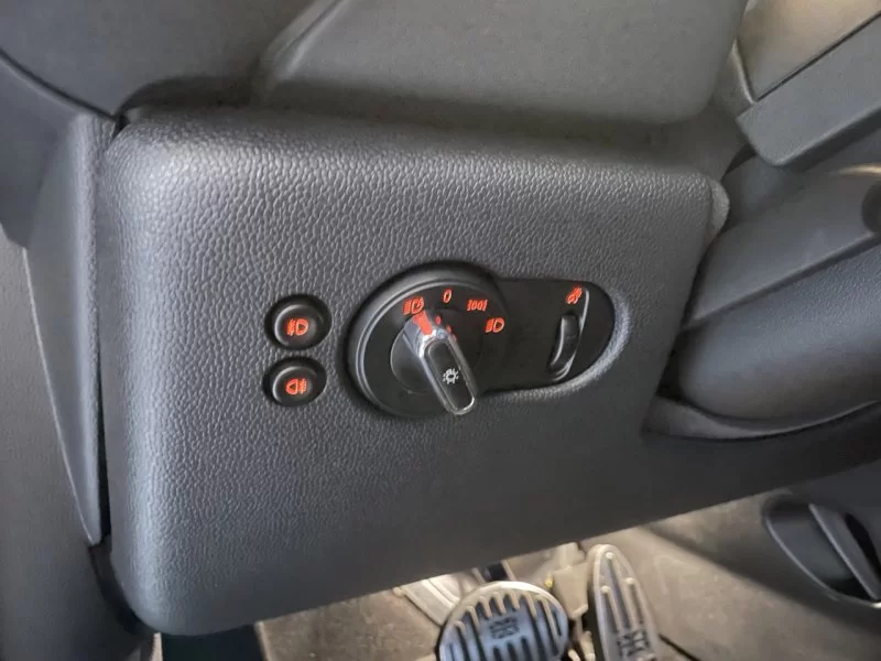

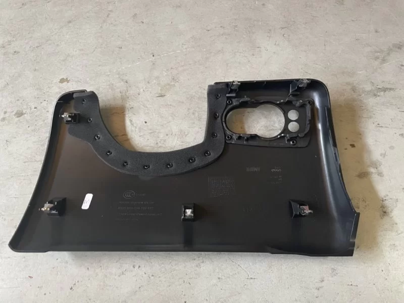

I just finished the switch and programming, the switch replacement was insanely easy, here is a pic of the panel removed so others can see the clip locations.
The factory headlight switch easily detaches, you just tilt the switch from the bottom and it will pop right out. Installation is the reverse, place the top of the switch into the switch retaining clip, you only need to ensure the top right hole (from looking at the back of the switch) is lined up and tilt the switch down into position, it will clip back in. Plug in the wiring, note the shape of the plug for the orientation. I made sure the switch was in the off position just to be safe.
Reinstall the panel, the switch is now in and you have one less blank button.

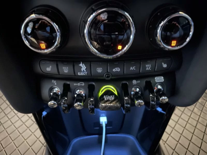

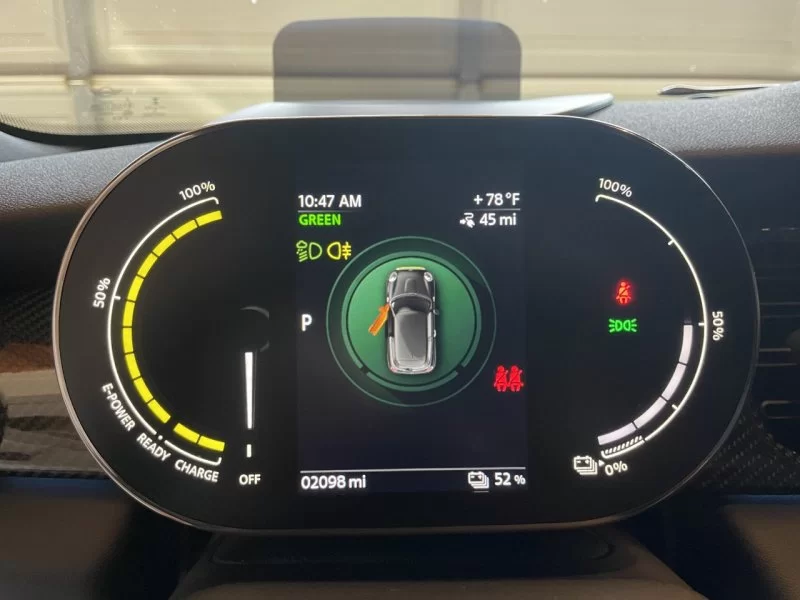

To test it, turn your car on and verify that your headlights turn on in the far right switch position, and cycle through the other positions. My garage is dark so I verified the auto setting and parking light setting. Push the top fog light switch and the indicator on the dash lights up. Push the rear fog light switch and you will see a new indicator you normally would not have seen to the right of the fog light indicator.

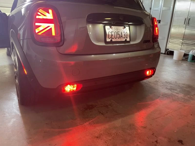

Now check to see if all your hard work paid off. Go to the rear of your car and the fog lights should be on.
If you have an Iconic like I do, there is still one more blank switch, what it is, I have no idea. I put a sticker on it so my blank switch OCD doesn't kill me. Thank you Sameguy for sharing the link to the switch and original coding instructions.
