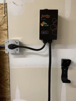

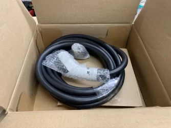

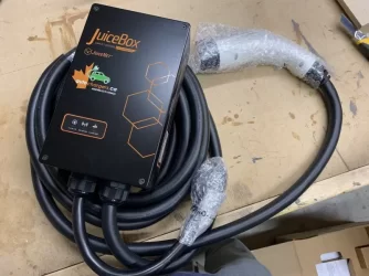

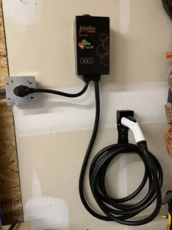

Just picked up my new JuiceBox Pro 40 on sale on Amazon Canada $100 off. Super easy set up. Wired the NEMA 14-50 myself and just plugged it in!

Looks like a great install!
Few long loops on the J1772 handle cord will be better in the long run rather than many small ones
I couldn’t agree more!
The cable is just so stiff right now as it’s still rather cold out. Once it warms up a bit I’ll strech it’s full length out and do just a few loops!

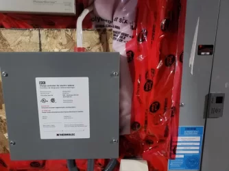

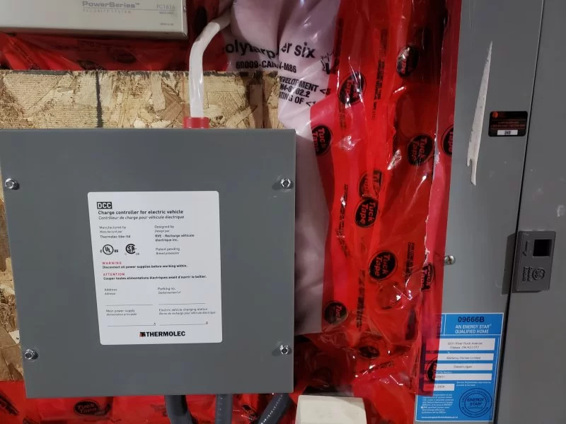

My panel was full as well. My electrician recommended a DCC- demand charge controller for electric vehicles that attaches to the panel. The cost of the unit, install of unit, install of 240v plug in garage and install of Charge Point was $2,000 + HST (Charge Point was purchased separately). I will send a picture shortly

Which charger did you have installed with the DCC ? Will your setup support a full 32Amp (7.2kW) charge for the Kona, assuming no clothes dryers or ranges are in use ?
