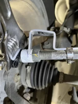

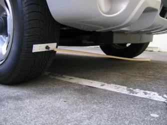

I use a laser level to check the floor and add 1/4" plywood shims under the tires to compensate. I also use a tire gage to make sure tires pressures are equal. Point the steering wheel straight ahead. Lie down on the floor on a piece of old carpet and sight along the wheels. Do camber and toe appear equal side to side? If one wheel is obviously misaligned that's a good place to start. Do any adjustments to camber first because camber adjustments affect toe more than toe adjustments affect camber. I use a carpenter's square and a tape measure to check camber. Square on floor (clamped to a block of wood so it doesn't fall over) is the vertical reference. Measure difference from the squre's vertical reference to top and bottom of rim and distance between to make a triangle, then work out the angle using triganometry. I am not sure if camber is even adjustable in the Kona since mine hasn't needed any adjustment.

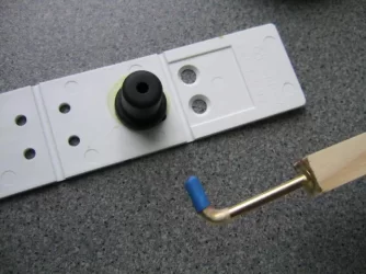

I adjust toe using some longacre toe plates. Simple to use but you will need to convert toe in inches to toe in degrees (see, you should have paid attention in math class). Make any adjustments equally side to side unless you sighted a wheel as way off and need to bring it closer to its mate on the opposite side.
Some other thoughts: Put your efforts into getting the toe right because toe affects tire wear and tracking more than camber does. I assume that caster is non-adjustable without heroic efforts or special parts so I leave it alone. You will need to jack up the car to make adjustments so bounce each corner after you lower it back down to settle the suspension. If a wheel is bent you will have an awful time trying to get a good alignment. Alignment settings are not one and done. You need to check, then adjust, and check again, then probably readjust and .... It can take more iterations and time than you expect especially while you are learning. Keep a cold beer ready in the fridge ready for when you finish.

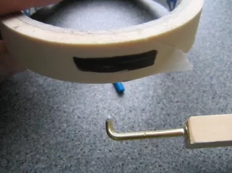

I did adjust my ICE car toe recently using the technique I saw as a teen, a stick anchored to one tire with a sharp point at the other end to make a mark. I mark the sharpie-blackened masking tape then carefully roll the car back half a wheel turn and make another mark. The gap between scratches is close enough to the total toe.

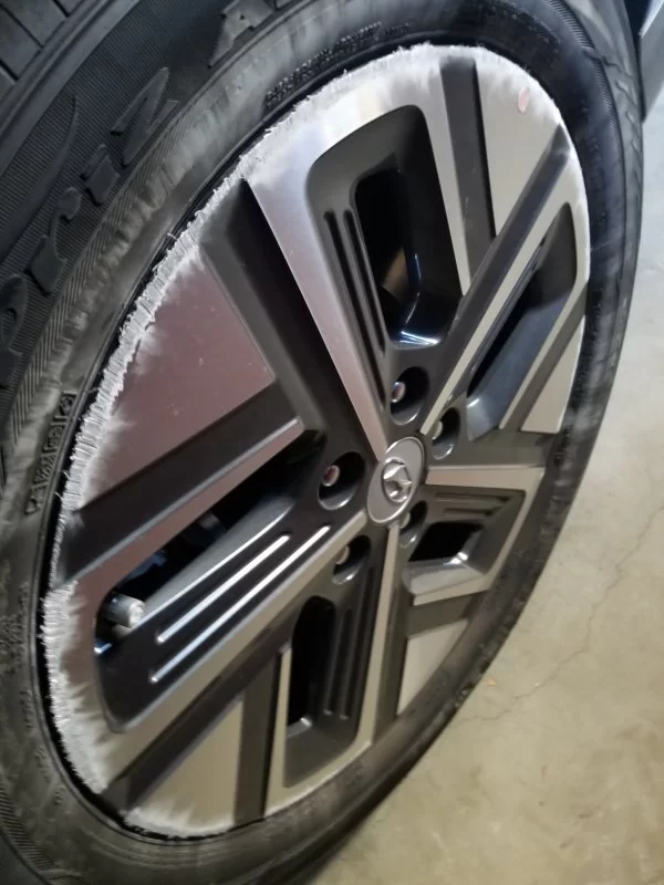

At 42000kms I took my 22 Kona in for a puncture repair (very grateful I had bothered to source a spare. The above mentioned Falcon FJ donut) and was horrified to find out that my right hand rear tyre was stripped to the threads on the inside bead by a miss alignment. Needles to say I bought a news set of tyres as I only had about 5000kms left. I didn't see the wear as the tyres are quite wide and hidden unless you can do youthful gymnastics, which my arthritic joints can't anymore. I now check regularly with a mirror.

Yes, not uncommon to have the rear tires wear down on the inside. This is caused by rough roads, or in my case, on winter mtn roads that had uneven surfaces due to plowing and melting of snow. My dealer tech said that it was not just the Kona but other Hyundais as well with this issue. Go back to the beginning of this thread to get the whole story.
