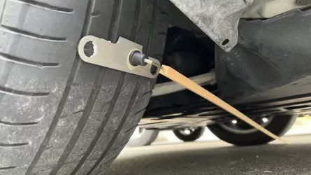

Also, how is that stick stuck to the tire and how do you roll the car with the stick stuck?
Well, the stick can be removed and replaced from the tag without losing its position. The tag is attached to the cleaned tread with double-sided tape like 3M VHB. The car is rolled so the tag goes over the top of the wheel. The other side has a strip of masking tape marked with a Sharpie so it can be scratched with the sharpened tip.

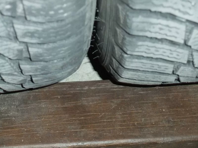

Maybe I spoke too soon.... Went to the garage and had a look at the winter tires I just took off. The rears are a bit rounded on the inside edge. Photo shows comparison between rear inside edge and a front outside edge. Does that wear pattern look familiar to anyone? I'll have to keep a watch on it.

Good thing you checked.
I have noticed a bit of negative camber on the rear wheels, but not enough to cause this kind of wear.

I've put an extra 8 psi in the rear tires to try and shift the wear pattern to the center of the tread. Actual rear camber measurements were -1.2 deg and -1.4 deg which should never cause wear like this. But I am not too worried since I plan on replacing Noah in about 35K and I think my two sets of tires will last that long.
Since my last post I have found info from owners of other models of Hyundais reporting excess inside edge rear tire wear and excess rear camber. So we're not alone.
To test the theory that camber and toe change with load, I checked the alignment again before leaving on vacation. With gear piled nearly to the roof and two bikes on the hitch rack Knoa was noticeably lower in the back when loaded. Fully loaded rear camber grew from -1.3 degrees to -2.0 degrees. Rear toe remained the same. I actually expected to see more change, so good job Hyundai on the suspension design. In my experience -2 degrees camber is usually about the limit before tire wear accelerates. After 2000km (including two days into ferocious headwinds) there doesn't appear to be any additional inside edge tire wear. But remember that I put the rear tire pressure up to 48psi cold, so maybe that's the key to make the rear tires wear better. Time will tell.
My Primacy 4s were down to the thread with that sort of wear. Invisible to normal casual inspection.

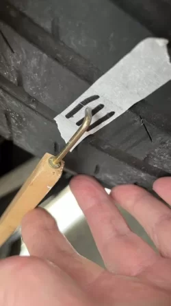

I'm using a magic wooden stick to precisely measure across the tire treads front and back. The fixed end is held in place on the tread with BlueTack. The razor-sharp end scratches a mark on a Sharpie line made on masking tape placed on the other tire tread.
I make a mark, move the car back half a turn of the wheels, then take another mark. Rolling the car back to the original location I make a third mark - which I compare with the first. If it's about the same then I'll accept the distance between the 2nd reading and the average of the 1st and 3rd as the linear total toe measurement.
There's a handy site here that converts linear measurements across a known span to the degrees used to specify the service limits. The 'span' is the front to back distance between the stick when placed at the front and back locations of the tread.

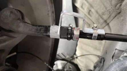

Before loosening the tie rod locknuts it's important to know where you were and where you're going. It's a very, very sensitive adjustment and a trap for the unwary. If you want to retain the existing level steering wheel alignment then the changes need to be nearly identical at each side.
From hard-earned experience I use a pointer on each steering rack tie rod to align with a mark on each ball joint, establishing my starting point, see photo.
The total change I made on the masking tape (each side) to achieve this entire adjustment was only about 6mm. Once the 24mm locknut is loosened it's very easy to lose the original setting so care is need to avoid going down a rabbit hole of not knowing where you were and then having a bad day.
