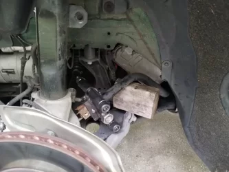

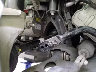

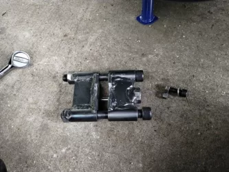

I've been having a huge amount of fun autocrossing my SE since it was a few months old. I'm a significantly better driver now. There is one guy in my class that I just cannot catch. I think this is partly due to the rather skinny wheels and tyres on the SE compared to every other G street class car. So I'm making the jump to G street touring. More mods are allowed. The key one for me being 9" wide wheels. A bigger upgrade for me than any other car in my class, which I'm hoping will level things up. We can also mess with both sway bars and fit coilovers. There are no alternative sway bars for the front of the SE, so I modded my stock one. The tool needed looks overkill but is barely adequate. Galling is a problem. My hole drilling jig is ridiculously simple on the other hand. Two nuts welded together, one drilled out to 10mm.
I will be fitting some shorter links. On my second new hole the bar just touches the tierod on full extension.
1st hole +13%. 2nd hole +25%. 3rd hole +40%
I'm now about +50% stiffer rear bar and 25% stiffer on the front. This feels REALLY good for general street hoonery and I'd definitely recommend this combination, though I'm pretty sure I'll want more at the back for autocross fun. It is starting to feel a little underdamped. I have found and modded a 919 H7 bar to go on, but another Saturday...

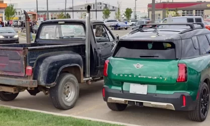

Went to a local classic car gathering with the local MINI club and got rule 1'd by a brodozer. The ones who really loved the U25 BEV have dogs/families, but there was a lot of vitriol from the classic car owners. #notapetrolsniffer
I think I need to re-visit the MINI rules.
What was the best classic at the meet? An Issigonis Mini?
