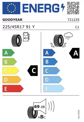

Asymmetric 6 8.7kg/t is class C Euro rolling resistance. It's probably nearly double that of the stock SE tyres. I'd rather use Yoko V701 with that much rolling resistance.
It's extremely hard to find truly low rolling resistance tyres in SE sizes in the USA. There is no US standard for 'low rolling resistance', so tyre manufacturers can and do call any tyre 'low rolling resistance'. Not a single one that I have asked for actual figures will reveal them. I have a set of Conti ECS02 'low rolling resistance' tyres that have higher rolling resistance than Yokohama A052...

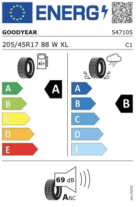

Found the EU label for the Eagle F1 Asymmetric 6, definitely not great for rolling resistance. I think I'll stay with the Asymmetric 3 as long as I can.
Eagle F1 Asymmetric 6:
Compare to the Eagle F1 Asymmetric 3:
Your labels are comparing different widths tires, which is not apples to apples. In 205 that likely going to be a B rating. Still, probably worse, but not as bad as C/you think.
That's unfortunately the fault of Goodyear's site, it says 205/45R17 at the top of the web page.
Edit: found the correct label on the page, same ratings except A rating for noise, like the Asymmetric 3.
right, I would trust the picture/label more than what the site says. Probably someone uploaded the wrong label or they don't have one for the 205. You can see if you can find label in 225 for the older tire to make apples to apples comparison.

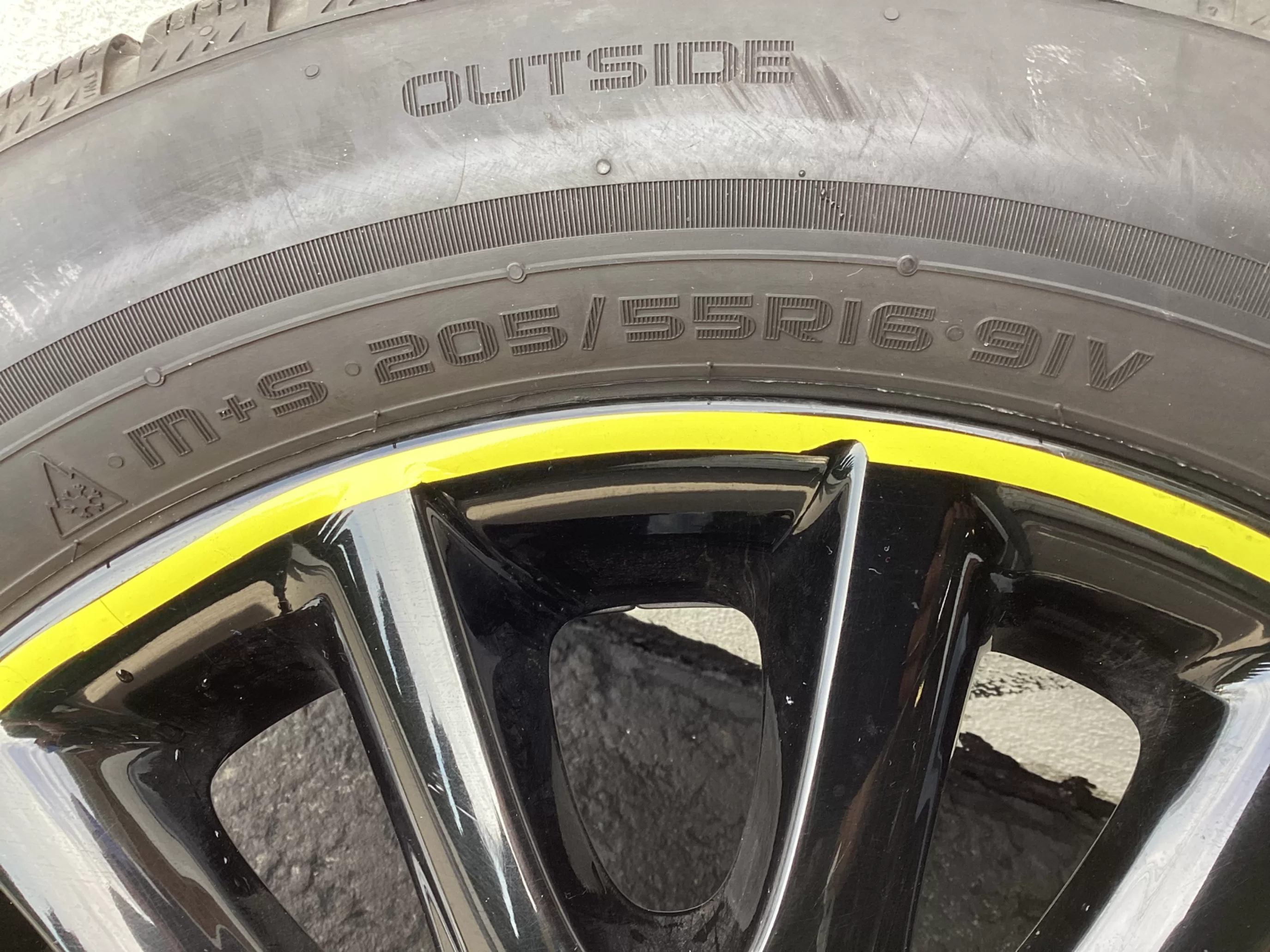

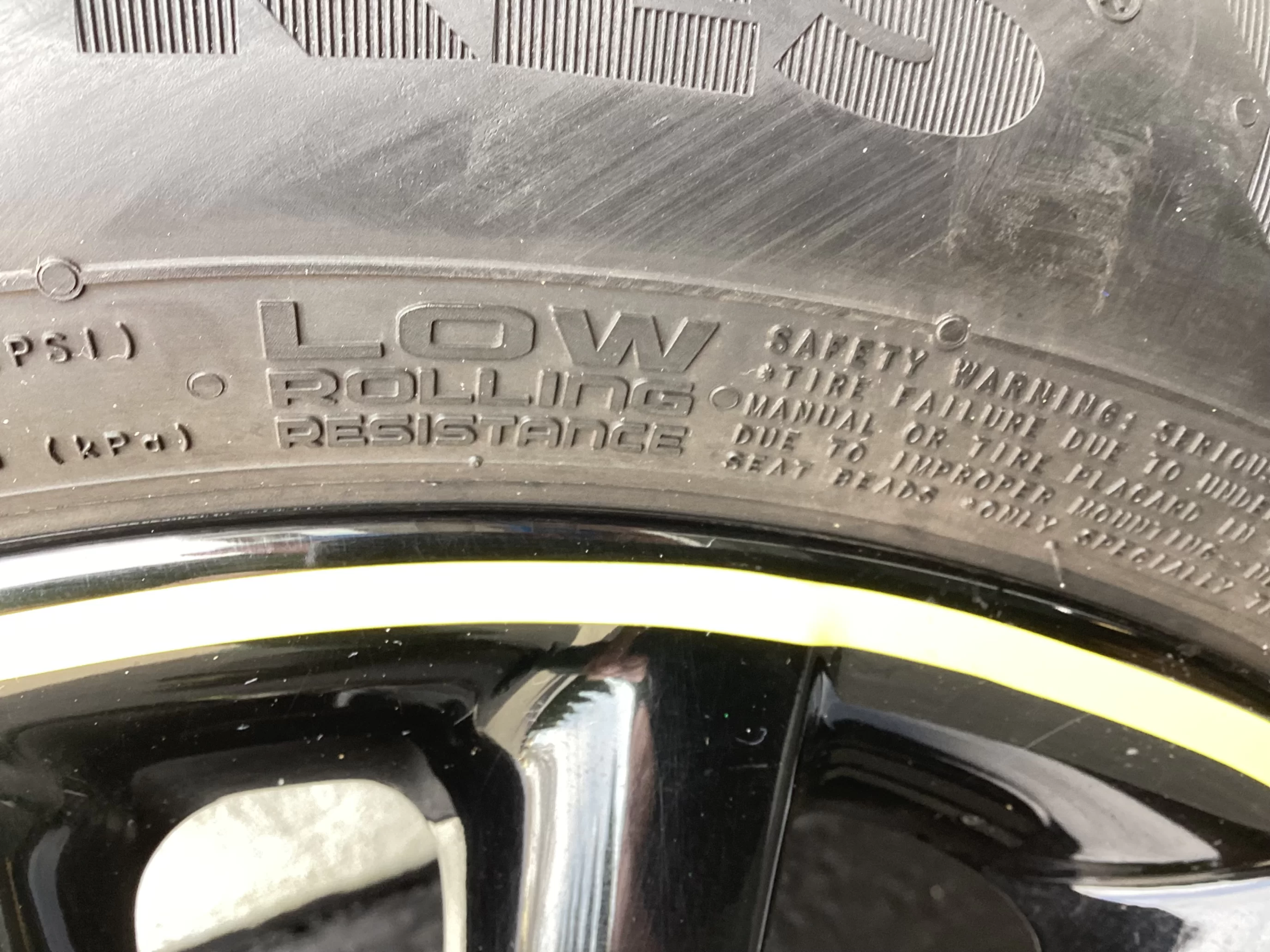

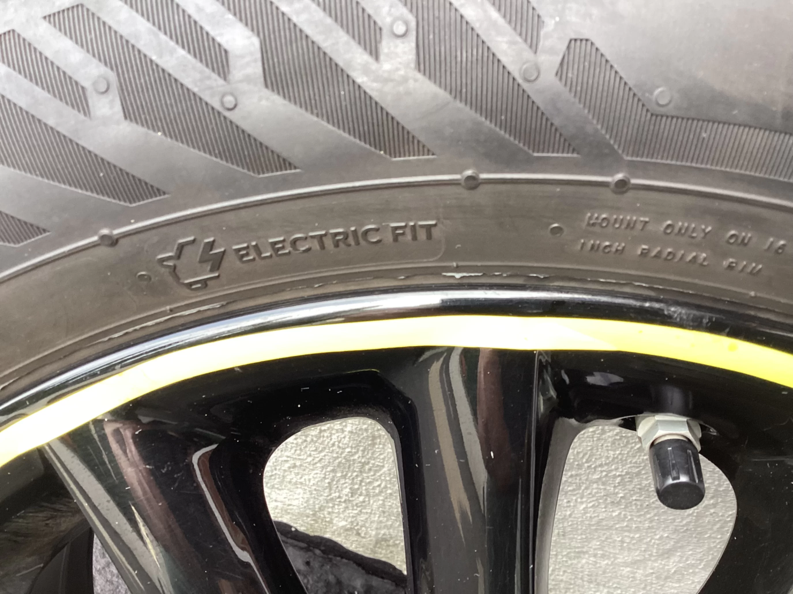

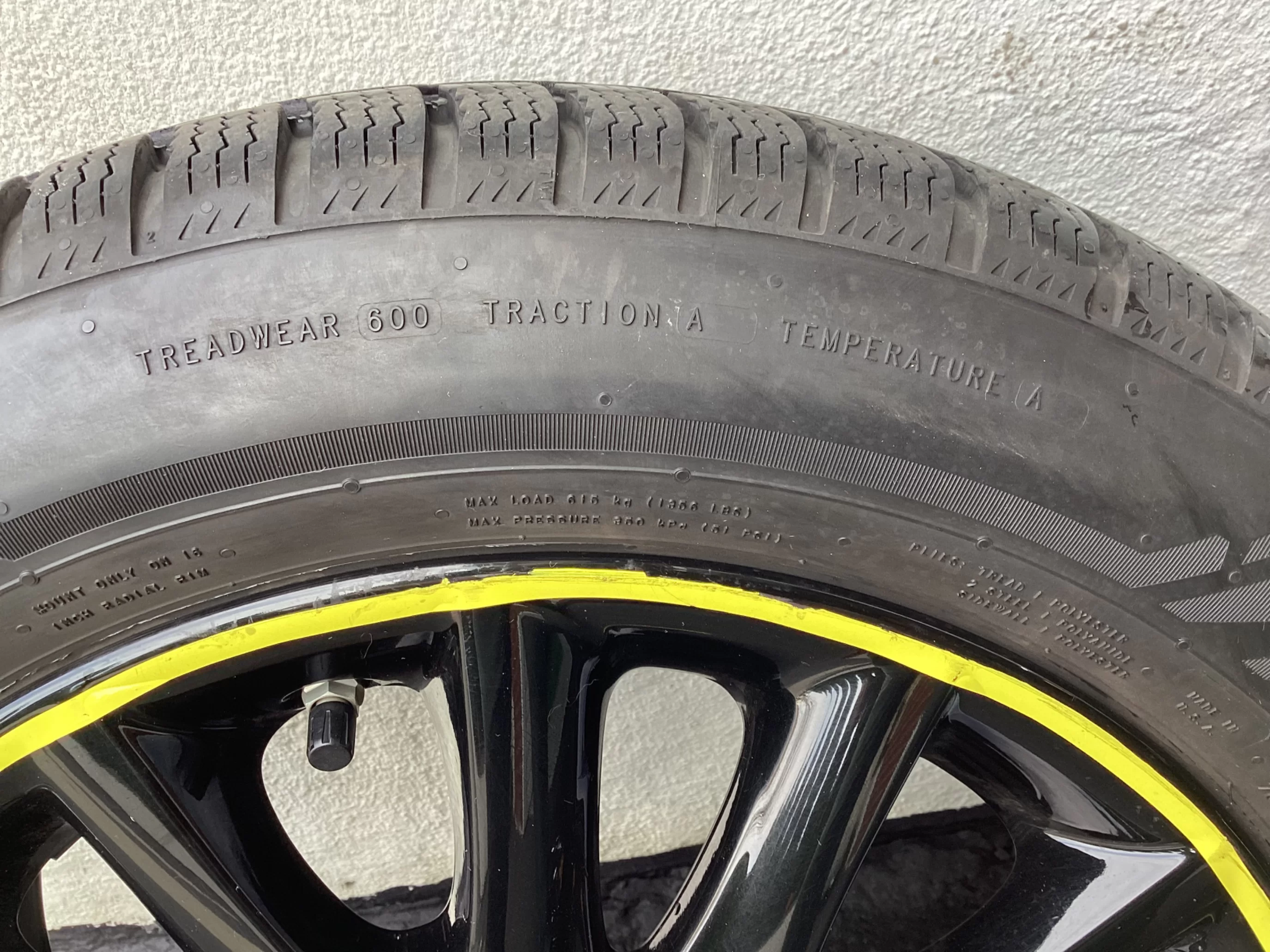

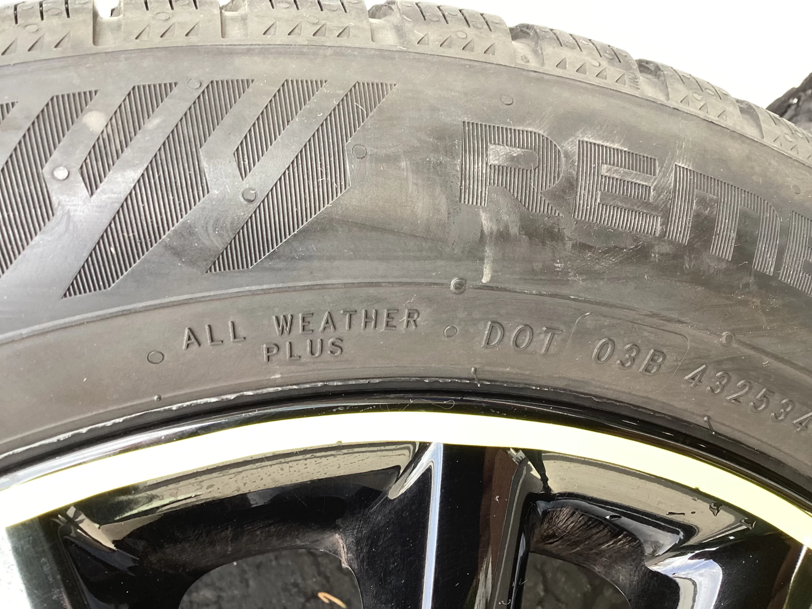

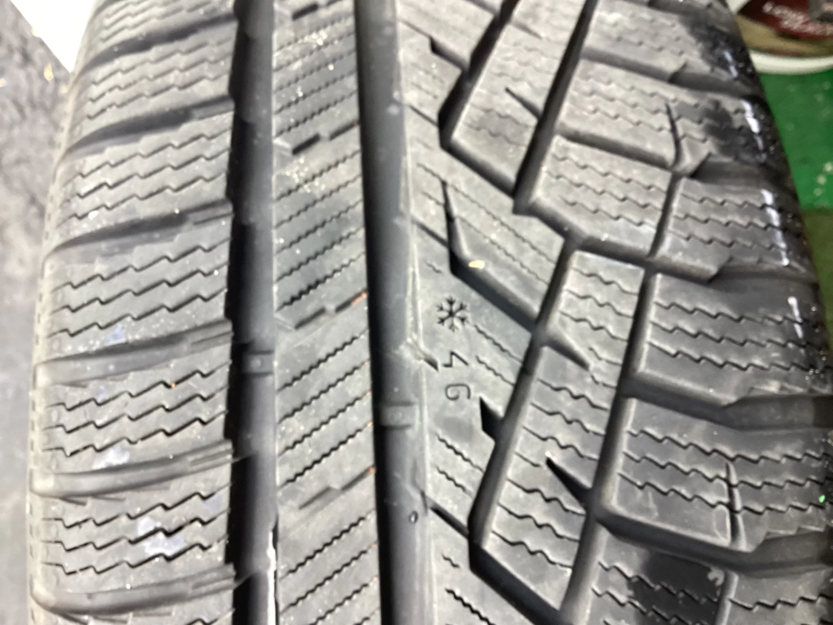

As you recommended WR-G 4 I’m using newest version WR-G 5 Remedy but for my 16” wheels I put 10 mm spacers as I was worry about front shocks to close for my comfort they come only 205/55/16 as I need 195/55/16 and I used longer bolts too driving through winter in NY and pat holes I highly recommend them .For summer I have set of Hankooks 16” on extra rims as I put them back today. Range wise over winter bc much colder I really don’t experience drastic change as Hankooks give better range during summer and Hankooks as summer tires are less noisy.If someone is not switching tires winter/summer those Nokians all weather tires the best choice for money and usefulness produced in USA .My Subaru Forester on WR-G 4 20000 miles later they look 70 % year around driving on them.That winter in NY was a coldest lately and on WR-G5 in 10-20’F no snow I never have range lower than 110- 120 miles 70% highway 30% streets . Pictures with all descriptions of WR-G 5 Remedy 6000 miles and snow flake on thread not wear at all.I keep my tires 2 PSI above factory recommendation 37/34 PSI and SPORT mode only.
