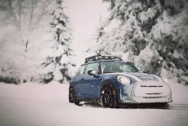

My SE in winter rally mode!
I've had Bridgestone blizzark, Dunlop wintersport, Continental "forgot the name" and General arctic altimax, none of them came close to the Nokian hakkapaeliita R5 in my application on the east coast, not to mention its low rolling resistance which showed literally no loss of range.

Thanks for the great photo!
