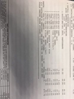

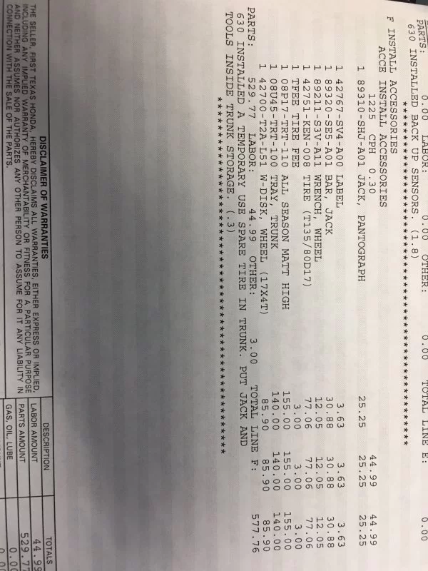

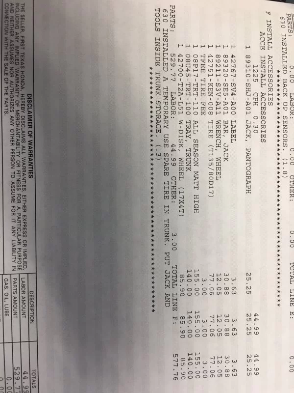

As promised, the official Honda spare donut tire kit from the Accord (with the rubber tray added $140). You can skip the tray or get it from WeatherTech or equivalent. The tray was meant to hold the tire but the tray from Honda is short, just the level flat part of the trunk, the tire is sitting up on the sloped part. Hope that helps a little. There are cheaper alternatives from eBay, etc. Be safe.. stay cool...

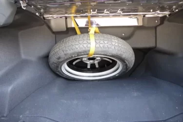

Has anyone created a way to secure the spare in the trunk to prevent it from becoming a projectile in a tumultuous accident?
How about like this:
The round holes are about 1 inch in diameter and are very sharp inside. I thought it might cut the nylon strap so I ran a piece of 3/16 plastic tubing around them. I think I will try and find a rubber grommet that fits the hole. It fits very tight and will not move around at all. It also gives me plenty of trunk space.

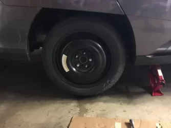

I mounted the tire on the rear (plenty of clearance) and then drove the car about 1 mile. The car handled well, no message about a low tire pressure and no weird noises. I believe I will only use this spare on the rear of the car because the weight distribution is 57% front (2310 lbs) and 43% rear (1742 lbs). So if I get a flat tire on the front of the car, I will put the spare on the rear then use the rear tire to replace the flat tire on the front.

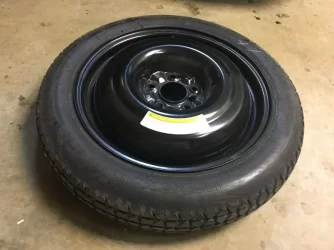

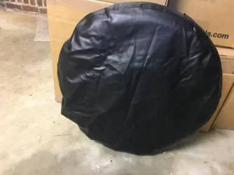

I bought this temporary spare on eBay for $80 delivered. It was listed as for a 2008-2013 Infiniti and seems to fit well though I did not drive with it. I also got this tire cover on Amazon for $9.59. My intention is to carry it only for trips away from home and hopefully will never need it.

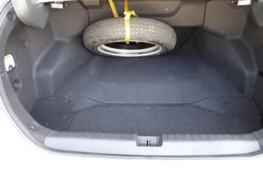

I just bought off eBay ($90 w/free shipping) the Infinity spare that @peekay started this thread with. Thanks so much for the research and posting! The size T145/80-17 is only a few mm (1/4") smaller in diameter than the OEM road tires and on my test drive with it installed it did not trigger the TPMS warning light. There were no handling or weird issues while driving with it installed on the rear and based on my 50 mph test, I would also be fine driving with it on the front to get home or a tire shop at that speed. The weight rating is 2149 lbs, which is ok for either the front or rear of the Clarity. A bonus is that the Infinity wheel is a light alloy and the entire wheel/tire combo weighs in at only 19 lbs. I'll "hang" it in the trunk like @bpratt did and keep a light Honda scissor jack and 19mm lug wrench in the "boot". I'll be much happier on road trips with a good spare, especially in the winter. It's light and easy to remove if I need the trunk space for a local errand.
