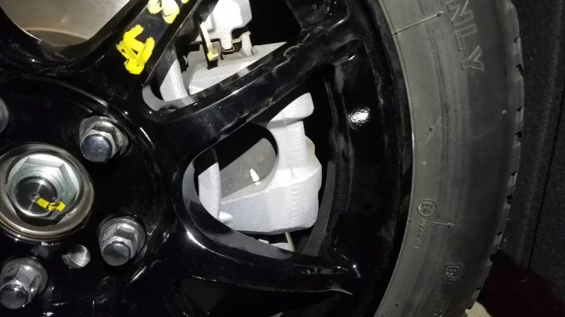

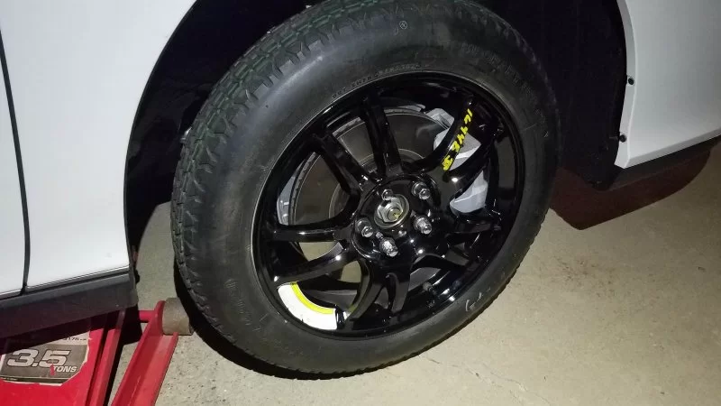

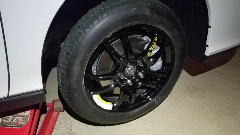

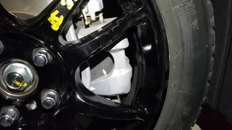

interesting. I don't specifically remember because I tried mounting my spare 6 months ago, but based on my pics, it appears that the spare that I bought seems to be a decent fit for the center hub, as well as lug nuts.
View attachment 3563 View attachment 3564
So here's a bit of bumbling explanation. To run true and stay tight, wheels need to be either hub-centric (tightly fitting the center of the hub) or lug-centric (lug nuts tightly fitting in lugs holes). With the Infinity spare, it appears to mount just fine, but it does not fit perfectly tightly to the center of the hub (and so is not hub-centric) and the OEM lug nuts are not quite the right shape to tightly fit the holes (and so is not lug-centric). Adding the proper hub rings (common with aftermarket wheels) and the correct shape lug nuts to fit the Infinity wheel (also common with aftermarket wheels), gets the spare wheel on the car securely. As I noted above, I'm not suggesting anyone do this, or even add a spare to the car. I'm just posting what I did and why.
