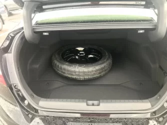

Will you please post and/or confirm the size of the spare you got? In your trunk photos the spare looks smaller than how it sits in my trunk. The size of the spare I got is: T165/80R 17 104M. It’s a Bridgestone. The tread is different than yours but the wheel it sits on looks identical to yours. Thanks! After a 2nd look... more similar than different in size I suppose.

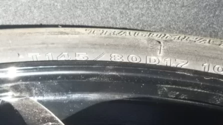

Will you please post and/or confirm the size of the spare you got? In your trunk photos the spare looks smaller than how it sits in my trunk. The size of the spare I got is: T165/80R 17 104M. It’s a Bridgestone. The tread is different than yours but the wheel it sits on looks identical to yours. Thanks! After a 2nd look... more similar than different in size I suppose.[/QUOTE]
Mine is 145/80/17. Yours is a bit bigger. Have you tried installing it yet? When mine is actually mounted on the car, it looks pretty close in size to the stock tire. I'd imagine yours might even be a little bigger.

If I understand how tires work, the 2nd number is a ratio related to the first number. So my tire distance from the rim to the outside edge is 80% of the tread surface width. (If I’m wrong, please correct me, I don’t know much about tires). If that assessment is correct 80% of 165mm comes to 132mm or 5.2 inches of tire to the road from the rim. When I do the same with yours, 116mm or 4.57 inches. Looks like I need to get that thing on the car to see how it fits, or return it. Good thing I got it local. —Also— I do not know what the final number of 104m means for the tire size. Need to look that one up.
Yes, that's basically right. The only other number that impacts the radius or the diameter of the tire is the 17, which stands for the rim size.
