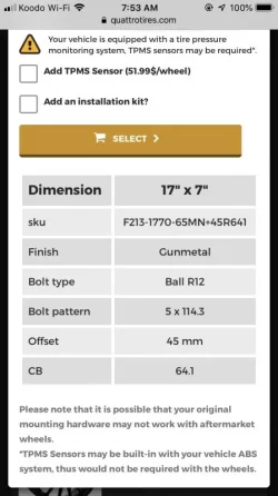

I bought mine from Quattro Tires. Offset was not an issue.

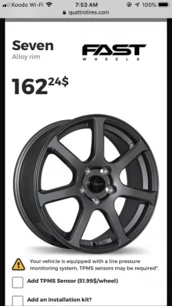

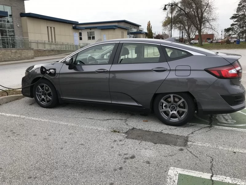

My take: this is probably a real, but minor, thing, as long as you pick a wheel deemed "compatible" by a vendor (so it won't rub the calipers or car body). I already bought a set of wheels with offset 40 (10 mm different from the OEM offset 50). Other people have done the same. So I am not going to worry about this at all. However, if I buy a set for my wife's car, all else being equal I will probably find a wheel that has an offset within 5mm of her OEM wheels (which may push me towards full 18" size snow tires, for reason (5) above, instead of the 17", if cost is not too different).

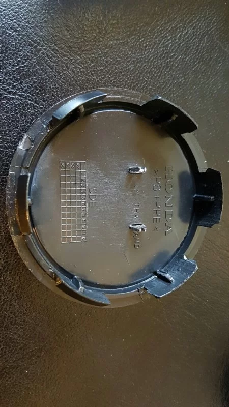

P.S. re. hub centric rings, also a question of mine above: per "dana", Discount tire direct
uses (if you have them install), but per my own order experience does not
automatically sell you if you buy online, Gorilla hub centric rings to adapt the hub size to the OEM. So I ordered them separately.
