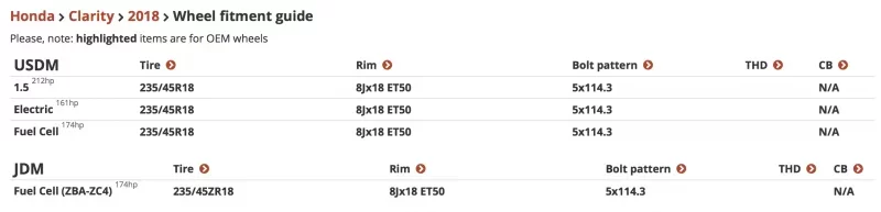

Interesting wheel specs here: wheel-size.com - use "search for wheels" upper right hand corner
(Just from a google, no idea if they are any good or accurate, but it certainly looks like lots of detailed info.)

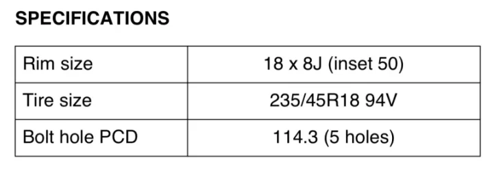

from the Honda alloy wheel installation pdf (the OP mentioned this):

Tiralc, those are the specs I was taking about. I was in a hurry when I posted and was having a hard time finding that pdf again thanks!
West1, I quickly did look into using some accord rims, but as I recall something (the offset maybe) was slightly different. I'm not sure if it's enough to matter though...

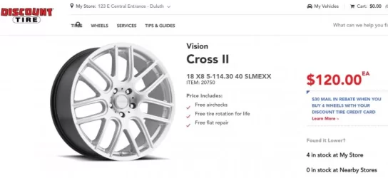

Discount Tire locally did not even have the Clarity in their system, but they're mounting my Michelin X-ice snow tires on 18" Accord-compatible rims. Scheduled to install on Wednesday. Is that a problem? Now I'm worried.

It has worked out great. They actually assured me that they would be carefully verifying the fit and space before installing all of them. They came over and reassured me that it fits and has enough clearance.
The snow tires are excellent and almost essential here in Duluth, MN. The rims I purchased from them (new) ran only $108 a piece for a total of $432 before tax and a $30 rebate. That makes switching the tires seasonally a cinch (they will even do it for me for free if I take it in).
Have driven about 700 miles on the rims and I can't tell a difference in "feel" or noise.

Cool, thanks for the updates! Do you happen to know what model year they referenced for the Accord rims? AKA are they for a 2017, 2018, etc?
Based on the SKU on my invoice, THESE are the wheels installed.
The Accord seems to have 17" wheels (or 19" on the touring). So, he probably took my specs from this thread that I gave him at the store.

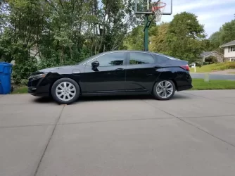

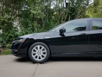

Sorry to bring up an old thread, but I just got my Clarity last month and got the snows for the upcoming Minnesota Winter. Wheel take-offs from an older Accord and 215 55 r17 Blizzaks WS80 at the Discount Tire Labor Day sale. Package about $650 all in.
I love Blizzaks!!
I've been using them since they came out. Imho, awesome snow tire - just replace them before they get more than ~1/2 worn down. After that, the "amazing ice stopping" thread gives way to regular snow tread.
Btw, there are supposedly even better snow tires. But, from a cost perspective, I still see Blizzaks as cheaper. Plus, the deep thread is an important factor in a snow tire. So, imho, any snow tire should be replaced after it's 1/2 worn, or sooner.
