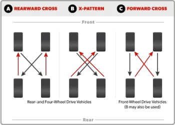

2 other things:
1. I still have snows on so I don't recall if the summer tires have a specified rotation direction, if they do you must follow.
2. Set the pressures after all done. I have always gone 2 psi over in the Fall, but since the pressures will go up as the weather warms I would stick to the 36 spec in the Spring.
