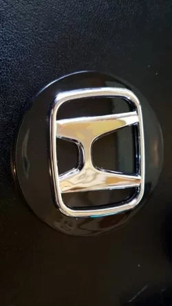

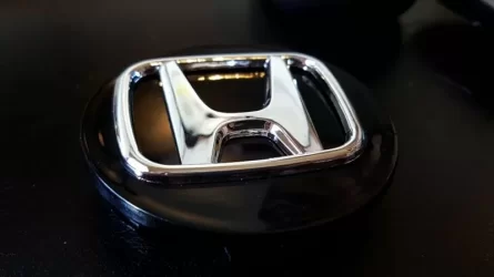

So I got my centre caps from eBay. The match the size of the "Wheels" centre caps that came with our rims. They are plastic, shiny black with a chrome Honda H. They say "Honda" stamped on the back but I'm not sure if they're really OEM or knock-offs. The "Wheels" centre caps have a thin metal band inside the teeth that hold in the cap. The eBay caps don't have this, should I transfer them from the Wheels caps to the Honda ones?

OEM are plastic .

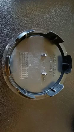

The ones I got from eBay are plastic too. They have Honda embossed in the back, which my husband says means they are OEM, but I don't know for sure. (It does say Mfr is Honda in the eBay ad.)
Here are some photos of the ones I received. 15422126820542.webp 15422126820111.webp 15422126819310.webp

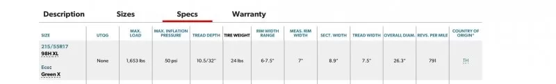

Question 1: When I put in 17” radius wheels on Discount Tire, specified to fit the 2018 Clarity, I get suggested wheels in the width range 7” wide-7.5”. They have a range of offsets that don’t exactly correspond to the width. Same thing with 18” wheels, at 8” wide—a range of offsets, and all much smaller than the OEM 50mm. In general, is it correct that there is some small range of acceptable offsets….and I can 90% trust Discount Tire to offer me only ones that would actually physically fit without rubbing or sticking out too much? Hobbesgsr implies this is so in thread in “Aftermarket wheel compatibility” post #1. I’m looking specifically at the Vision 17x7.5 which have offset 40 (since I can’t find a US equivalent of JCEV’s inexpensive Costco alloy wheels), and user “dana” has actually used them (for both of these, see earlier in this thread “Snow Tires & Rims”). ​

Width: Not negotiable, but some wiggle room: width has to be in the right range for the wheel above. Specifically, 7” wide wheels are usually best fit by 205-215 tires; 7.5” wide wheels best fit by 215-225 tires; and 8” wheels usually best fit with 225-235. Exceptions allowed. (From https://www.tyresizecalculator.com/charts/tire-width-for-a-wheel-rim-size-chart)
Question 3: Is this idea of approximate matching of tire width to wheel width correct? Anyway, for winter tire handling, should I be pushing for the widest possible, or narrowest possible, contact (instead of just the middle of the range)?​

You should not change the offset by more than 5mm. As it is measured from the center it is not affected by a narrower wheel. Changing it will affect the scrub angle, which might affect handling and potentially also the driver assists. Maybe I’m overcautious.
A 17 inch (215/55R17) X-Ice here in Canada is 65$ cheaper than the OEM size, so it offsets part of the cost of the wheels.
7” width is the measured width for that size tire, it’s what I installed.
