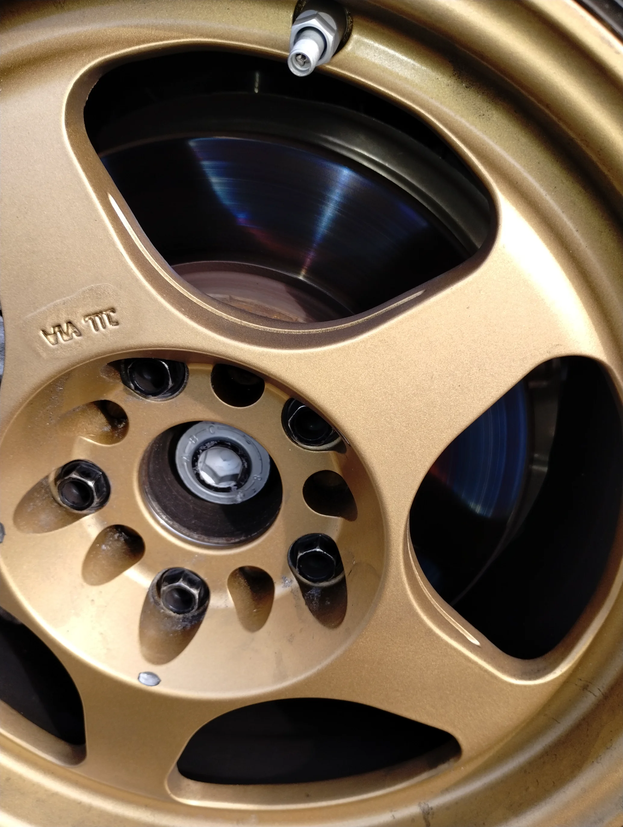

I had my brakes turn blue during fun runs, where you're back on course just a few minutes after getting off, over and over. I don't know which of these mods helped, but I bent the brake dust shields out some, to catch more air. Also partially cut and angled the cut portion of the plastic under car panel ahead of the front wheels, to direct more air towards the brakes. Plus I was so low that I was scraping them often before cutting them partially. Finally, I think the choice of wheel design makes a big difference. I was racing with 17" Motegi Tracklights the final year and I don't remember smelling brakes that whole season. We still have nowhere to race on Oahu going on 1 year!

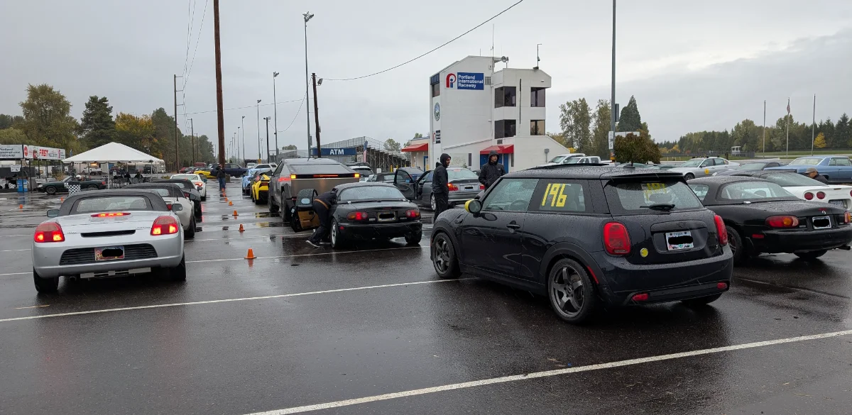

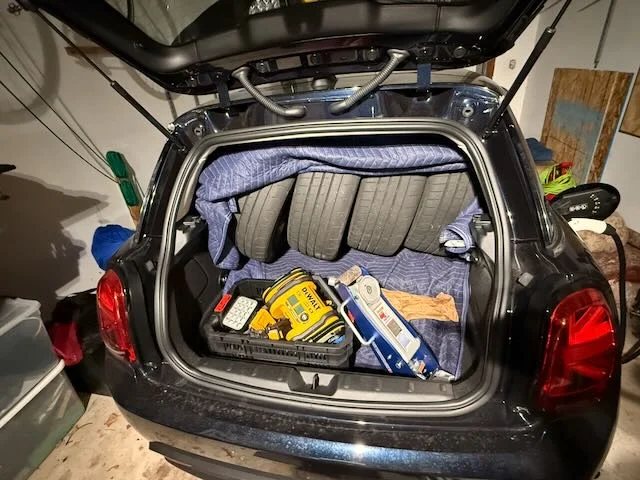

Attaching some pics of my car at a few events, and one loaded up for race day the night before. :)

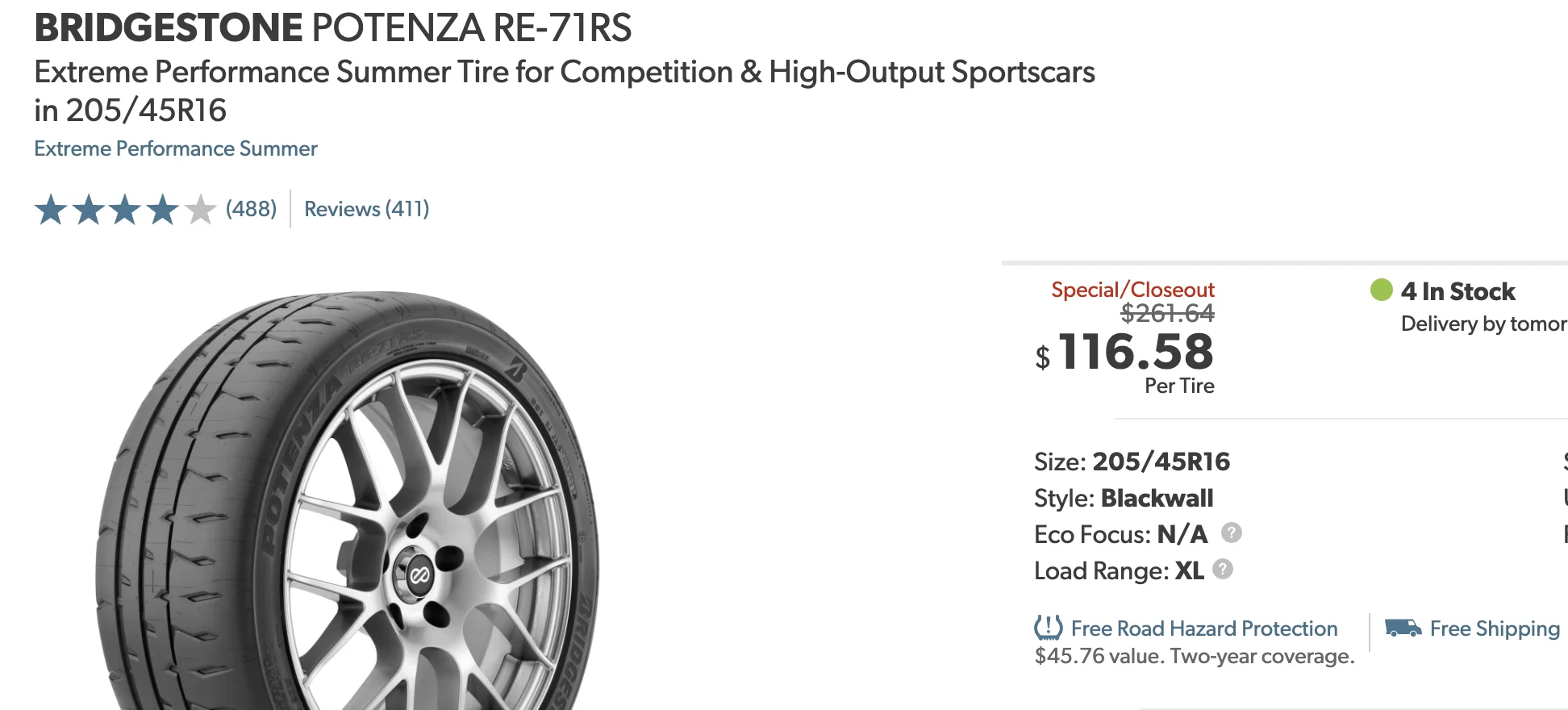

Since I wore out my RT660s, which are a great beginner tyre, I've been running various tyres on the front, but mostly Yokohama A052 on the rear. I really like them there, I'm not alone in FWD for that. Others prefer RE71RS on the rear (the Civic Sport alien). The Re71rs is being replaced by the RZ version next year. It's hard to go wrong with Bridgestone, they are popular for a reason. I've not tried them on the rear. The Yokohamas are prone to overheating if used on the front, they are the best tyre for cold weather. I've sprayed them on the back at 80F... I have run Vitour P1 on the front. They need heat, ideally 90F+ weather. I've also run Nankang on the front. They didn't feel great but were pretty quick, possibly because I had 225/45 pinched on 7" wheels. They tolerate southern heat very well. They aren't horrible when cold, unlike the Vitours, which are just scary.
Sizes, I suggest 205/50 or maybe 215/45 on 7s. I don't like pinched tyres, 205s were my favourite on 7s. Avoid tyres with a low load rating, or you'll need to run crazy pressures. My record being 44psi hot on 245/35-15 84W on 15x9s. Trying lower just slowed me down. Those did stick better than anything else, though.
Which tyres are good for you depends on your local weather, but Bridgestone front and either Bridgestone or Yoko rear would be a great place to start for many. Ask people at your local club, or just look at what they are running... There is a new Vitour P1 coming in for next season optimised for cooler temps, the x-01r compound. I'll almost certainly be getting an enormous set of those to chase Teslas in EVX. The best 'wet' tyre is the Conti ECS02, not the DWS which will chunk. I used to do quite well in the wet on RTs, which suck. On ECS, I do really well, probably top 10 pax if everyone had run in the pissing rain.
