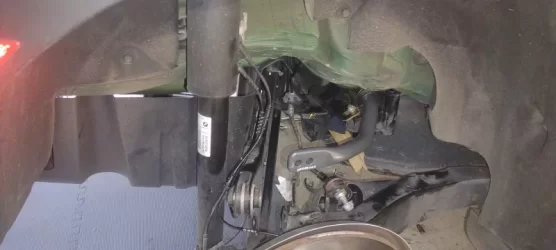

View from the back, after pulling original bar. The plastic thing at the bottom is a jacking point.
AIL4fc8fZpx7WyI_ZkZrUMYJ5bI4aIqv_UvESD8rbfmy0v6wwbkhef0wVUP-_9SQ-q14C-s3c40C9aODzwGH6ZC55y7P_G94GUAZ83a4eibYmbXTZ5Zn05VK8d6lJGZsUNc6PqBDrb85Yj9NDsavbm0XJRpWokI7ClZ-7xFN7TYmoVZUnv34GIHXamGYeDQ4Sri0bH4G_f3XkrErvCxdEiBwaWTkDc-Fi1L1Er5iS1382-lraMOYK-O_Lh0rRMx0hcSUgnfoDMKNVnd8HkfmikP5Dxv9sTL2P19pin97gAAl1QVkrlLyQj8e2s7p8ZO4q2lMeUgv8jUYshcMYNtj6a9kMMxWI3iDN_TRfgr_852kwJ7CUNhrQKWVbD4Yhm2MLXOTceOHEAtYtyLMV8cqImqhcqQe3bArPAlqHNMI-81gVYxv57SRQBrK5TIBSK5smY2kMCwL-Tphi0lzoOg2MZ1eW7tY-8by5dLD4zC8NPjcQECVbgCtpBZksTnqUxbLKNaCv8SwKJldHmyr-t-dVE8-VzElekK9rWvnfqZIrFsgK2Y1MbSyYr8JB-tkUIWlqwYfoSTSnvqebPB0PeY4i6ANIHrruwkiy_X6xFlZd4UgthN-5dxf3c5uXEiKhYgQNfz1-FqrEROyEf544dJMiKcEugv7x1WLD3o2QdkxeoAGBBTTvomc4_2jb2hGQbb9mAkp8ZG4plnAaK-UuG1YosiiUgsusdvIXRlnL_RpMfoStNDM2Vw1zFTka7bx2OGhsYsxr0x_ELGC1Y5qqrk5jTIj_u6cP-hkLDL70jyl_wAZZfa9FXv7nlshv68ePsVXM-rqKWiM7ocqI1-wPr8SD_fEj31YDuOm5ILwB22NAhk3-acqkeoBOF6BXpF_quqzwh_78_hXcloAajZBiTMFsk8E4AM=w1347-h606-s-no

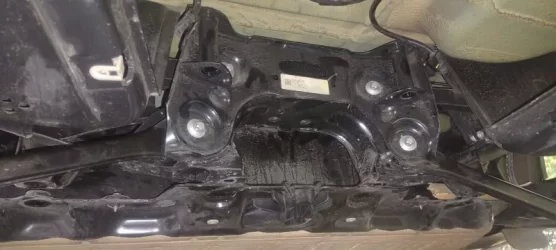

View from the right side, after bolting new bar to subframe. Only 2 hours to get the job done from here! I pretty much knew what I needed to do by this point. Disassembly had some dead ends I wasted time on.
AIL4fc9ijCXyR1lBJ4_3IXiZr-QvEilUURq8JQKexz4Cwwkdf0BEXL4N_BjP6sUqU5YX2D-AkWfOUis2a0WNACjOMJ3ctQybJyHwRN2Lq5shb1oS_S690uB9HDaZcTg1ZYOFrXwSxY74iwP1HEaI5hqmIUxe3j74fc7wG9-LblOMlJs_jzsZ9n57tfTLTQSmnIRscKi1OK9CXYDeO8O4gkfEhdCIhH05sUkahSYoW3deChou1jD8cwIKwDxUrLNKIfp7UPMrLMuilv571DUwQjtguXgYPboqeEEsDiqcXuFK_fQpXWLRRQsPef7erJ3iGG4hFC1AOsrHEYeRyZRAxQWqcKxuyXUz7f95gA_61253cHIr6rpNRn0-X_LX9f_STWhEwcszLD_CsNx6kcB64KTKZCqbxo8uQf9IFF-WTOmVyOJbyX4djdRMeMyqCiEckC7f796pZp_Ba6j3uNa06NCnpeUecUyOEo2dflc56AquoEc8gD3vBOGTcWZO9eUKVfx0JFOy7fmWdBGRenY3eDIOllXTSlYeA6SgnpE2gyIfyFhXk5Zq23ll78QOZaL84Xck22CZ92qznrIURP-opL79XcaWrYy_LcQYnIKJIzOSWqv8dce189XeO43Et4MNRv1516yITU0UCLrvb_fkBp0-S6wJbtMssvx5Pz2eQw1H2uatxD0oW9Iib2pltkxLrC7lWAgKfjCEHFtxElFQOO64cEqHE0tdw5aDyo0xYYV2XWgS6fiELBIbPgRLdGc4BbJHUaAcQCA1PR9RGC-gDOcnthTBeKMzyet56DBPkUKguLN6eJVJSVqbi6dEGM8VcIZwApJskE6lLVedpE44arX_-Csrcf-uSWZYjzmuZsLV6XpdH3IoagUKSmROROSySZmNA9dTJNotwELsBMpgbtecGsM=w1347-h606-s-no

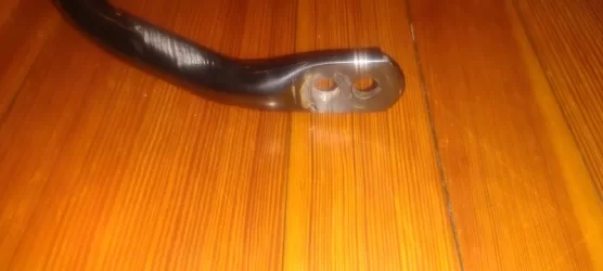

Can you take a picture of the extra holes you added to the OEM sway bar?
Missing photos below. They were showing up, then they weren't.
I did make a post or thread about adding holes to the stock bar. Can't find it now. Holes are about 5/8 inboard of originals. They stiffen the bar about 20%. The fun part was squishing the bar flat.

So you used the stock sway bar end links with the OEM sway bar with the new holes and it was noticeably stiffer? That is awesome! I love free mods!

Stock bar lever arm radius is 6 ⅛" my extra holes are at 5 ½"
