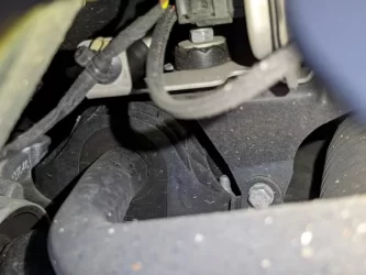

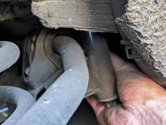

You know what makes me wanna cry? The front ASB bracket bolts in from below! You can reach the back of the rear bracket with your hand... WTF did they not make the back like the front? First photo showing my hand where the rear bracket bolt heads SHOULD be, second photo is the front bracket with the ends of the screws poking through the top. I think it's entirely possible to put threads in the bracket and insert the bolts from underneath. Once you get the stuff out.

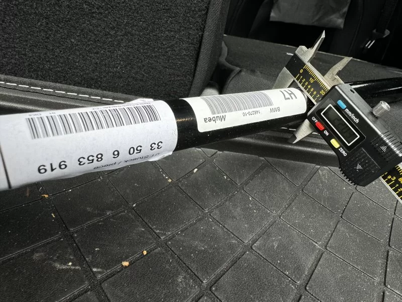

According to my bathroom scale it come in at an even 4lbs. Weighed myself with and without it three times to ensure I got a consistent measure.

Looks to be 22mm, will get you a weight shortly!
4 pound is very light, I wonder if it's tubular? That would be awesome actually.
The NM Engineering 22mm bar is um.. 22mm diameter basically 7/8". Measured 9 lb. 11 oz at the limit of my 10# food scale, and 10.1 lbs net with me on the bathroom scale.
