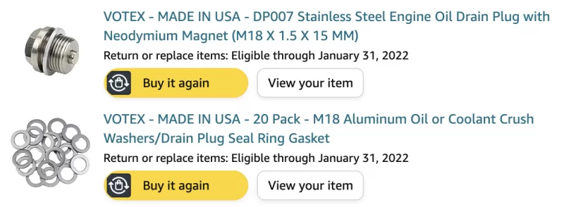

Sorry, at the pub. Search on Amazon for Votex DP007.

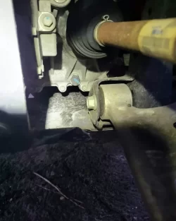

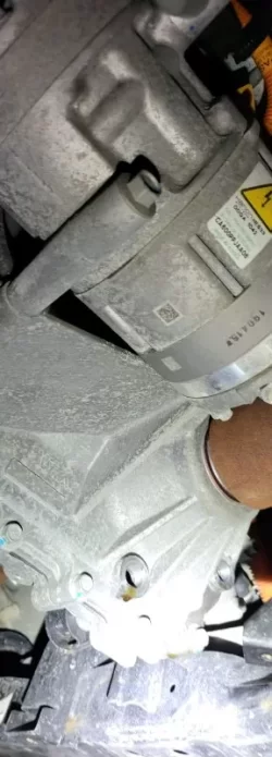

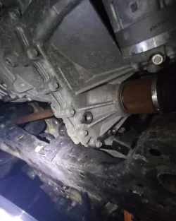

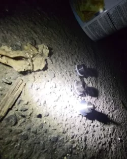

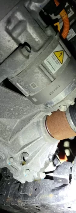

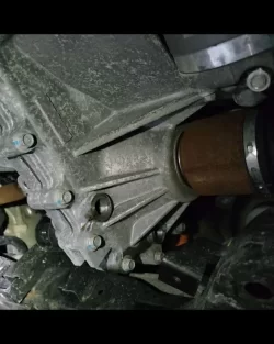

ok so today finally did gear box oil change...
started out late in the afternoon the night caught up with me and so did the cold today was supposed to be warm 36F as long as sun lasted in the sky....
so started out taking the splash panels apart, looking at gear box I thought to my self probably just need the rear one out ... " Wrong " you just need the front one wasted a lot time doing this "specially putting it back together after wards " pretty simple 4 bolts front part and 3 in the rear and 8 plastic push bolts around outer rim holding in place. ( you can see gearbox drain plugs if you take out driver side tire ) black bolts with blue markings.
the 2 bolts in gear box had giant flat head nuts/screws I had to use 1' socket with rachet to get them out my replacement magnetic bolt nut/screw should be much simpler to get in/out as there more area to grab on. 20220125_181858.webp Screenshot_20220126-002420_Photos.webp
as far the oil it came out black in color and bit cloudy as I empty the collected oil back to bottle for recycling no metal fragments that I could see.

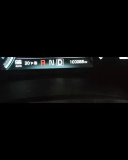

100,066 Miles by the way took car for spin I have to say looks like it got bit quieter. but will do real test tomorrow

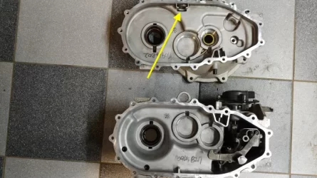

An Ioniq owner over at Ioniqforum.com posted photos of the insides of the gearbox after having to rebuild it due to a bearing failure. And, as clear as daylight there's a damn magnet installed! Checking the Russian teardown video of the Kona, it appears that there is one there as well, although completely covered in metallic debris. That also explains why the debris parked itself at the small web that now clearly is there to hold the magnet in place.
Since many of us have seen metallic debris in the oil, I can only wonder if the magnet becomes fully saturated and can't take any more metal?
Perhaps tomorrow I'll find an old magnetic compass and run it over the area to see if I can detect its presence through the casing.
