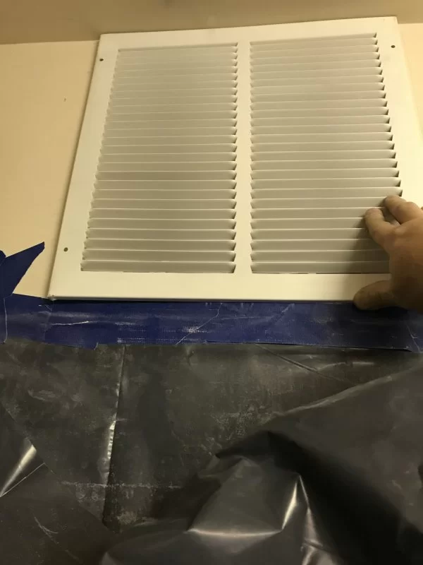

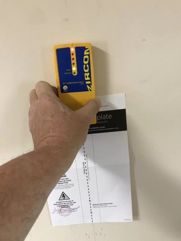

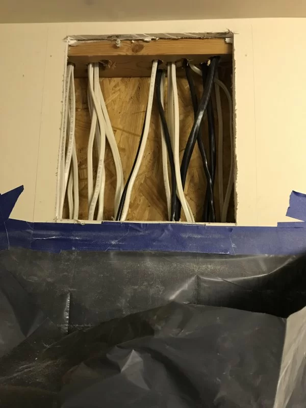

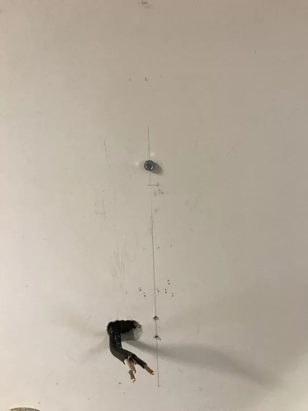

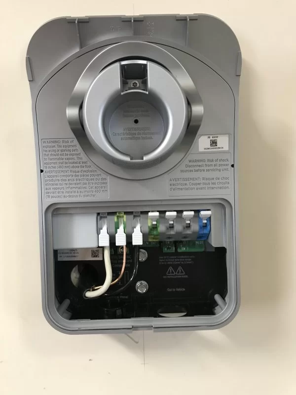

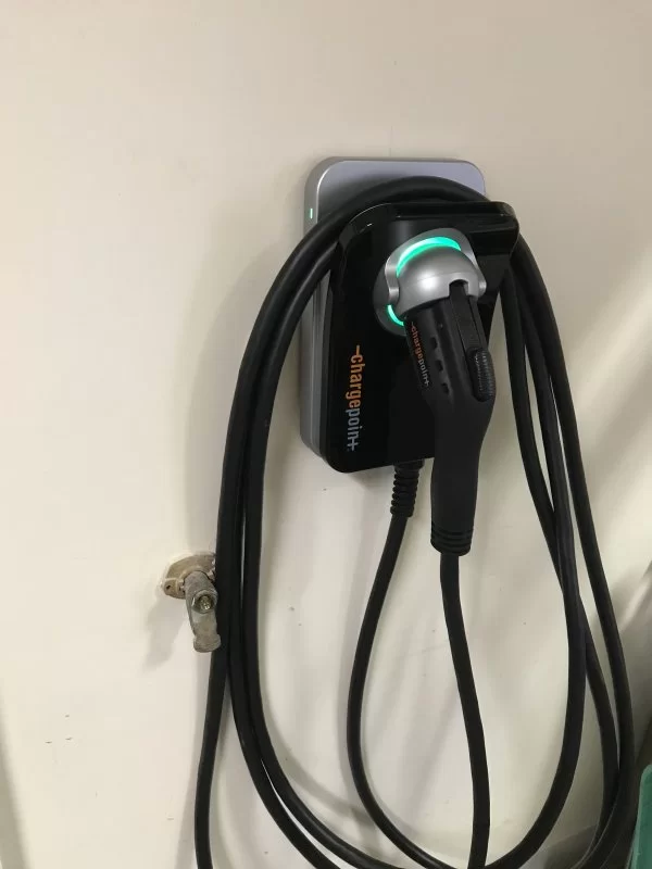

Here’s my cheapskate method to get 32 amp Level 2 charging with Internet monitoring of energy. Helped to have newer (20 yr old) house with 200 amp service.
-I bought an open box, direct wire ChargePoint off EBay for $450. Comes w mounting hardware (even drill bit and nut-driver bit) and the hookup is easy-peasy spring loaded push tabs.
-25ft of NM-B 8/2 wire for $27 (If you need 50 ft it’s $55) and $9 for a 40 amp breaker. (Home Depot)
-locate stud in garage wall, use provided template to drill opening in drywall, go to attic and drill through top plate of wall and fish wire to breaker panel. (My panel was in garage and I cut an opening above it to fish wire and covered it with a $10 louvered air vent cover
-Pay licensed electrician to connect wire and breaker to panel so you never mess with live wires and have proof of code following installation. My electrician charged $100 for the service call and was in and out in under an hour
So if your a DIYer (even with no desire to play w electricity like me) and you do the grunt work, you can get it all for
as little as $600-$625 (depending on how much wire you have to buy). If I did not have easy access to attic, I could have installed surface conduit, pulled wire and let electrician do similar hook up.
Notice the green glow of success and green WiFi led indicator in last pix.

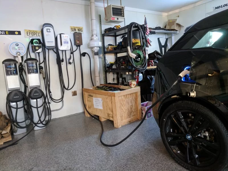

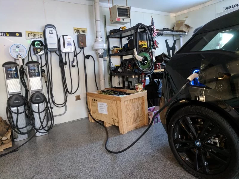

I've been testing and comparing EVSEs for about six years now and have written many reviews (some posted here on InsideEVs) and I can definitely say that there isn't a one-size-fits all solution. People need to think about what features, if any that they would like to have before shopping price.
FWIW, I love to have the WIFi capabilities and smart charging features and I'm willinig to pay a couple hundred dollars more for those features. I just posted a review of the JuiceBox Pro 40 (I have three of them) and it's definitely very high on my recommend list. Heres the review if anyone is interested:
http://bmwi3.blogspot.com/2018/04/ev-charging-product-review-update.html
