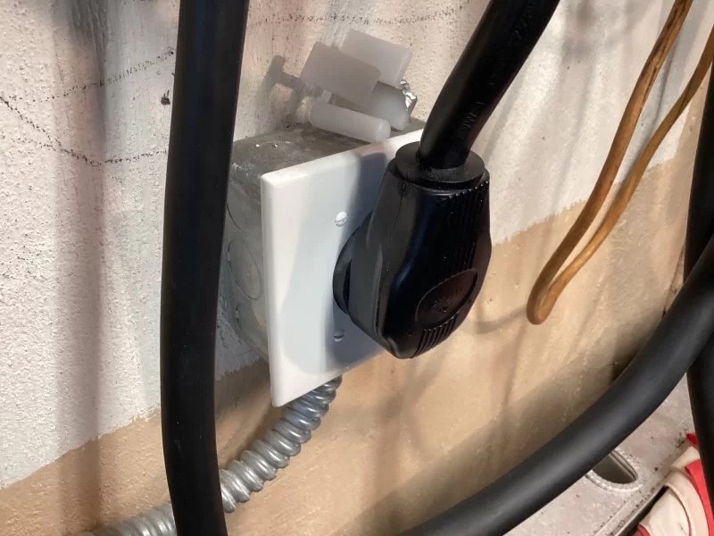

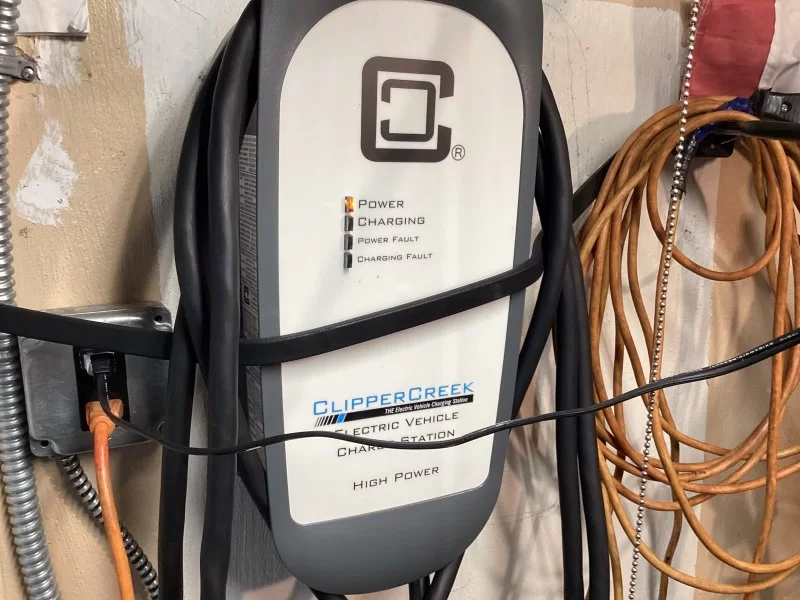

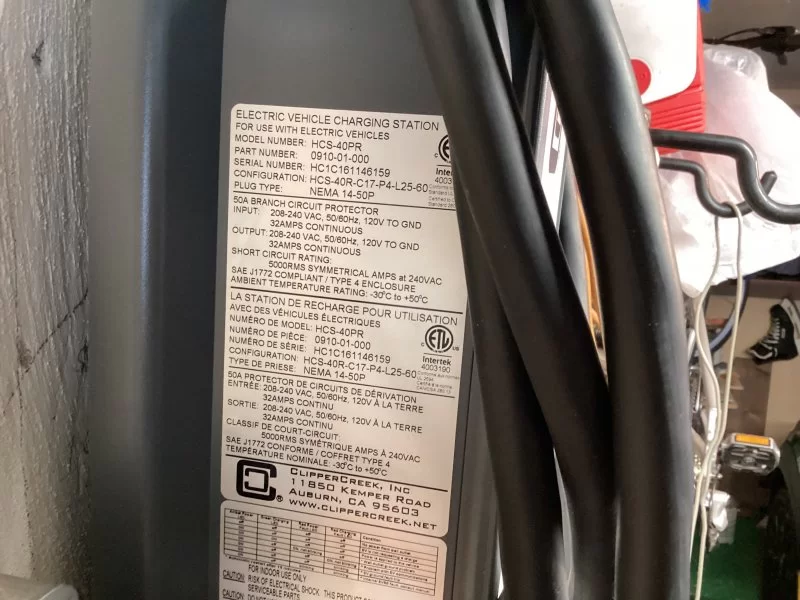

Clipper Creek /very good support /build in California/ Model HCS -40PR with rubberized plug you drop nothing happens/plug in or hard wired /32 AMPS that’s what SE takes /Plug NEMA- 50 P . 5 years Warranty. I was used for 6 years with BMWI 3 and now I’m using with SE no issue .Have to be protected with 40 AMPS double breaker in a panel .My house have only 100 AMPS panel no issues.Good unit I highly recommend .25’ of wire very flexible no kinking good quality very flexible.

If you try to read mypost from February I have the same issue dealer did not found nothing wrong with car and I was really piss of but i email UK Germany and NJ headquarters My garage L 2 charger was working correctly bc I charged my BMW I 3 correctly and suddenly two weeks later miraculously everything start at fine without any dealer interference since February I have no issues charging on my L2 charger at my garage using Clipper Creek for I3 for 6/1/2 year 32 amps and now for SE240volts
Your SE charge at 7.4 KW at home L2 charger in USA They send those cars here with UK setting when you read that crab they saying you can charge a crab with 11 KW is not through . My dealer send me to DC charging station bc he said is nothing wrong with car . Those dealers at list some of them don’t no much about SE . My preferred charging is my garage only bc owning a solar panels cost me $0 to charge

My L2 Clipper Creek 32amps charger is plug permanently .I ask manufacturer if this could effect live of a charger they say no and is pulling only minimal current .After over 6 years is working good and a plug is Nema 14-50
