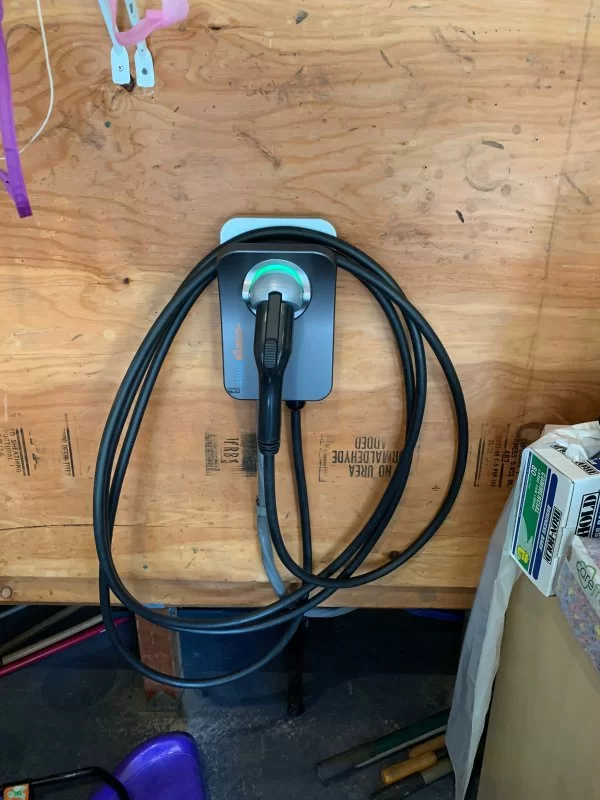

Even though the MINI can only draw 32A I wanted to future proof as best as possible, especially as I had the EVSE installed in the garage, and hope it will last a while. So I went with the ChargePoint Home Flex and had it hardwired to an 80A circuit. I had an opportunity to test it out with my parent's Model 3 over the weekend and the Tesla took the full 48A it is capable of taking (2A short of the 50A the ChargePoint can put out in this configuration).

As an aside, I realized after install that I qualify for Connecticut's rebate for both the charger ($500) and the install ($500). You just need to have a qualifying smart charger installed this year, and allow them to manage/throttle/block your charging between 3 and 9 PM 15 times a month for June-Sept. If you don't "opt out" of more than 2 of those "events" per month, you get $50 for each of those summer months. Seems fair to me, and until they get a separate meter for my EVSE, probably better than trying to play around with some type of variable rate plan. Anyway; look to see if your state has any rebates.
