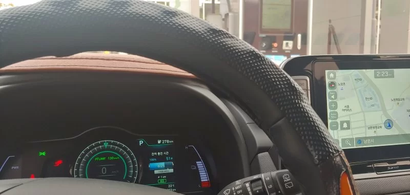

Here has something happen, one of KONA owner just finished recall by automaker.
After that he start charge, but charging speed just 1KW with FAST 100KW chager.

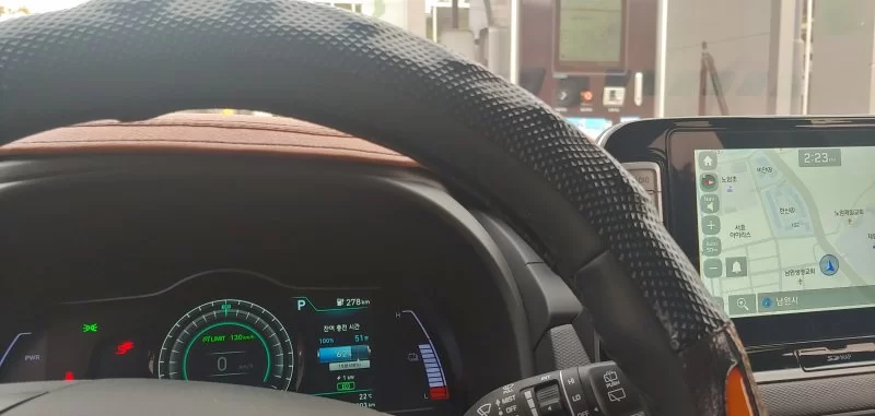

Looks like they did a flakey software update, do you know if they changed his battery or any other details?

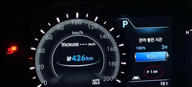

PS Here has another 1KW charging photo after BMS upgrade..

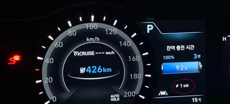

Thank you Kenny, lots of interesting info on the Korea EV forum. From my initial survey it looks like the recall so far is just another BMS update that increases its sensitivity to undisclosed variables. If it detects a problem the BMS will flag with a warning light, cease charging and prevent the car from starting. At that point Hyundai will inspect the battery in consideration of new battery pack replacement.
There is some anecdotal information from folks who have already completed the recall in Korea suggesting a decrease of 3% in available SOC after update, and some folks experiencing 1Kw/h charge rates when SOC reaches 90% and the charge rate may subsequently increase( sounds like it may be also regulated by other variables ? battery temperature),folks are having a hard time selling their used Kona EVs as no buyers want them now and there is some movement already on a class action lawsuit in Korea(loss of residual value and mental anguish). It does not look very good at all.

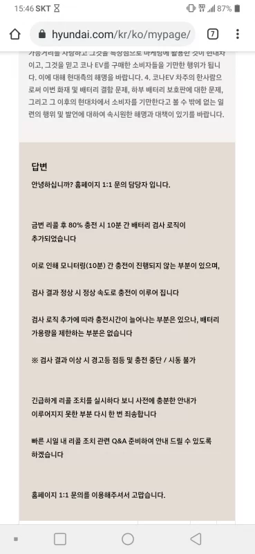

Automaker has confirmed BMS update detail.
Upto 80% charging speed is same as before.
But after 80% automatically staring check function of battery..
Estimated checking time is 10~30minute,
if everything is ok then restart charging to 100%!!
PS Not sure 80~100% charging speed..
Most of members said 1~5%!!
