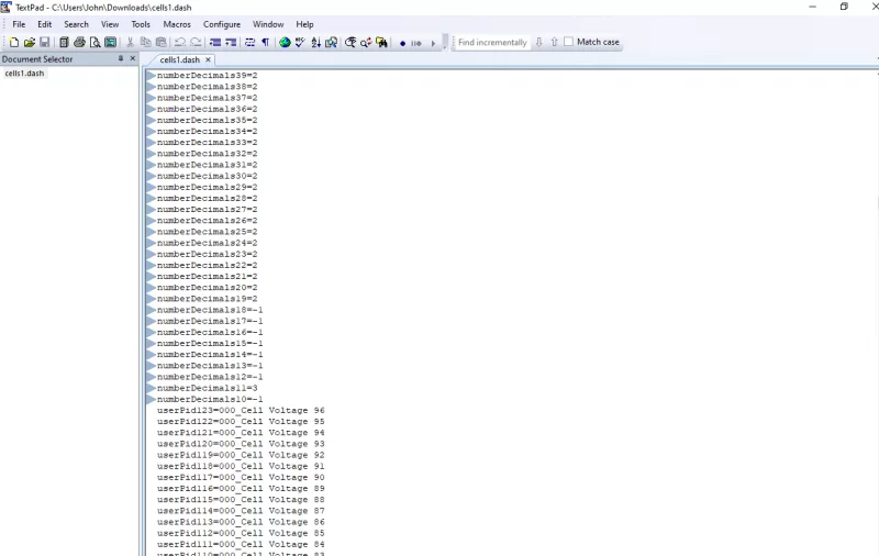

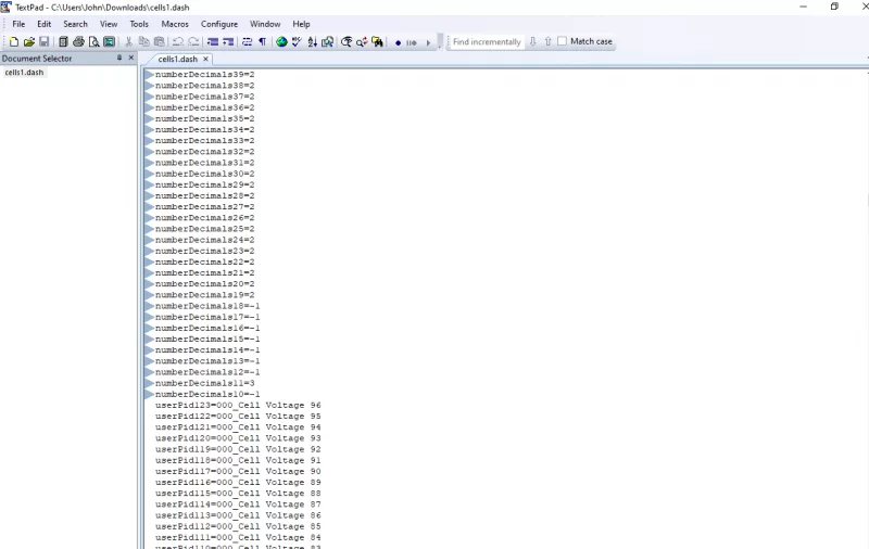

I did it and it was a pain in the butt.. took me a while..
So for anyone else - You can export the dashboard from Torque Pro, and this produces a text file which you can edit in a text editor. It's then much easier to find all the user PID numbers for each Cell Voltage entry and then edit each coresponding "numberDecimals" entry, then save and import the file back in.
John
John
Or easier still - Here's one I made earlier:-
NOTE / DISCLAIMER - Save your current Torque Pro dashboard if you want to go back to it, because this file WILL overwrite all your Real Time information screens. This file is provided without any waranty or guarantee of satisfaction, but WILL save you a shed load of time. Change the extension from .txt to .dash (forum won't let me attach a .dash file!).
John.
