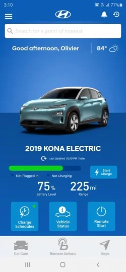

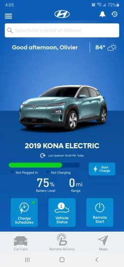

Almost 3 hours so far..
range shows zero...
when I dropped off the car..
"If P1AA600 is found, additional repairs are needed. This TSB will be updated once a repair is available"
Well that's comforting! Apparently the process can fail in an unspecified way that they aren't entirely sure how to fix yet.
