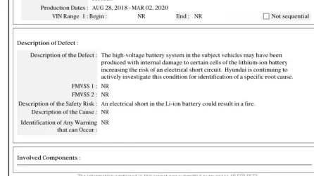

Recall 196 now shows on US Hyundai Recall website..

I queried my VIN and there is a battery repair recall now for my VIN..
Received notice today from Hyundai saying a safety recall has been issued on my Kona Ev's Voltage Battery System.I should park my vehicle outside
and/or away from structures until the recall repair is completed. Vehicle build is Feb.2019. I have charged it twice a week at 100% since I bought it
in May, 2019. No problems. (charge from reg wall socket in garage) SO the poor car is now outside (in the rain) I'm hesitant to make
the service appointment. If they do not sell many and do not service many Kona Evs do they know what they are doing?
