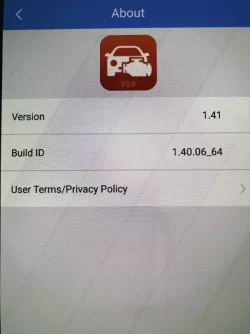

After installing MaxiAp200, check in "Me", "Settings", "About" and look at the Build ID.
It MUST be 1.40.06_64 in order to work with the beta.

My app is 1.41 1.40.06.64

You have a 64-bit App, which is good.

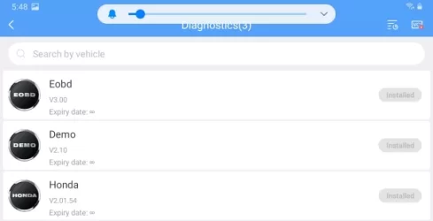

You need to look at the Honda Diagnostics version.
It should look like this:
You need to see the 2.01.54 on the Honda line.

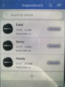

i deleted the data and logged in again. I searched for the Honda, and only v2.01 showed up. I installed it, unzipped it - then refreshed, still no bête showing up
Removed the package again and this is what shows up

The diag app - do I need diag Asia, Eu or USA?
édit: i had diag-Asia, so I removed it and it asked to me install again
