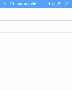

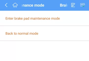

I confirm I received the update for the beta code. Now, I can read the battery condition. Have someone tested the other diagnostic functions? The function for parking brake maintenance is no longer working with the beta update. I tried my second phone which did not have the update and the Electric parking brake function is there and it is working perfectly.
Finally the problem with the parking brake functions is that there are indeed 2 function buttons present, but there is no text written on the buttons, but buttons still work. The top button is used to activate maintenance mode while the bottom button is used to return to normal mode.
