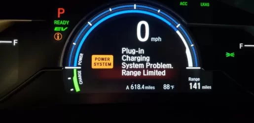

Started the charger and 30 minutes later it stopped. And got the dreaded Power range limited error.
Now tried the one next to it just in case after starting and stopping the car a couple of time (was going to say engine but that's not the case now :)
Update. Charged to 100%. But Engine and Power System lights stayed on, and Info notice about Plug-in Charger System problem.

Bought my Clarity PHEV on July 23rd. It charges flawlessly on my home Chargepoint Home 32Amp/7.7kW charging station. Started charging it at the office Chargepoint station on Monday, 8/6. It worked great. This morning, I connected it again to the same Chargepoint station at the office and it stopped charging just after just .0013 kW. I removed the chargepoint connector, put it back in the chargepoint machine. Powered on the car, saw the "Plug-in charging system problem. Range limited error." Powered off the car, tried a different chargepoint connector (on same chargepoint station). Plugged it in, the green light stayed lit for a minute or two, started flashing rapidly, and went dark. The chargepoint station in both cases indicated it was waiting on the car. My Hondalink app indicated no charge was occurring. I tried clicking the "start charging" function on the HondaLink app but it made no difference. The error message on my dash that I mentioned earlier disappeared after moving the car. When I returned home, I plugged my car into the Chargepoint Home charging station and it charged fine. FYI, I've been using the same charging station at the office on my 2016 Ford Fusion Energi for about 7 months and never had a problem. If I had to guess, it would seem to me that the Clarity PHEV is being overly sensitive shutting down charging. Honda needs to fix this pronto. Had I known about this issue 3 weeks ago, I would not have bought my Clarity PHEV. Other than this significant problem, I love my Clarity PHEV.

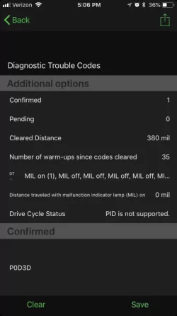

I didn't have a chance to plug my OBD the other day, but yesterday when the problem happened again, I was able to, but after the error had gone away but engine light stayed.
Code showed P0D3D
Code showed P0D3D

When I had my one day subscription to Honda Tech website, I downloaded a list of all the DTC's but not all the information behind them. Here is the description:
P0D3D Battery Charger Input Voltage Sensor Circuit
Attached is a general description of how to troubleshoot but you might want to buy a one day subscription to www.techinfo.honda.com and research it there.
