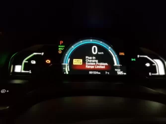

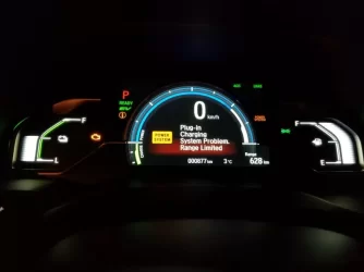

Hello everyone! I'm new to the forum, as I'm a new Clarity owner (Touring model), from Toronto, Ontario (Canada).
We received our car on Feb. 15, and 9 days later, I ran into a charging error when plugged into a 240V public charger. The green charging light on the car's plug-in port was blinking rapidly, then would eventually go out. Charger did not show a fault (I tried multiple chargers in various locations to see if this would be different, thinking, maybe it was a charger error).
This happened on a Saturday, so I anxiously waited until Monday morning to take the car to the Honda dealer. They hadn't seen this problem (car's too new on the market!). They did a "system reset", which basically means they removed the negative terminal on the battery (under the hood, not the main battery on the bottom of the car) to restore factory defaults.
The error went away, and they were able to charge normally. They release the car to me and said "let us know if there are any more problems".
Fast forward 4 days, and the error pops up again! Both times, I was a 240V public charging station (we don't have charging at home yet, as we live in a condo, and it's an uphill battle to get charging installed there).

Anyone else in this boat?
