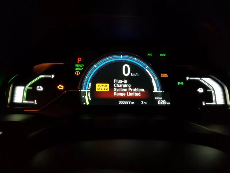

jsm, I'm very sorry to hear you're having the same problem (but glad to know it's not just me....I thought I was going crazy!). Did you get the error on the driver's instrument panel?
I think you mentioned you did get a message. Just wanting to compare if it s the same as mine.
Also, after plugging into 120V at home, did the error clear by itself?

Hi Eva, yes I had exactly the same message. When I plugged it into 120 the error message did go away.
