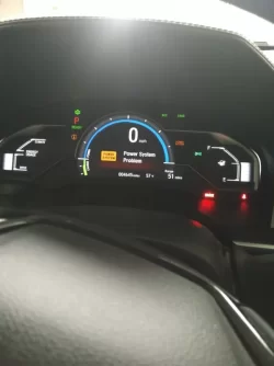

Encountered the same issue today where I was not able to charge at 3 different Chargepoint stations. I've been charging at the same stations for 3 months without any issues until today. Power System problem message appeared on my dashboard. Brought the car to the dealer and they are aware of this issue since Jan 2018. No solution at this moment. But according to the Honda mechanic it might require a software update. In the meantime, he told me to avoid Chargepoint which is the most popular charging station in my area or to try to use Level 1 for charging which of course will take forever.
It's frustrating to say the least with this inconvenience. I am going to be discussing this with the Honda case manager tomorrow.
