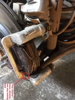

Brake inspection: the car sees service in severe winter conditions, therefor I remove all the brake pads and re-lubricate all the points on the pad backing plates and calipers that require brake caliper lubrication.

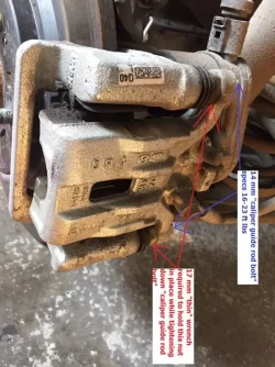

The rear brake caliper dis-assembly (with the e-brake module) was a non-issue as the caliper body was removed in the same manner as was employed for the front brakes; of course one has to be careful with the rear caliper body not stressing the flexible rubber brake line OR the wire loom for the e-brake module.
One "gottcha" to speak of when removing the rear brake pads from the caliper carrier:
None of the online videos (or the linked shop instructions below) mention that if one wants to temporarily remove the current rear brake pads, the "pad retainers" one way locking barb (all four brakes have these, but the fronts were not an issue) will make the job impossible unless one pulls the bottom of the pad such that the barb is "bent backwards"...just be sure to straighten the barb with needle nose pliers prior to re-lubricating and re-installing the lower pad retainer.
https://www.hkona.com/rear_disc_brake_repair_procedures-1096.html

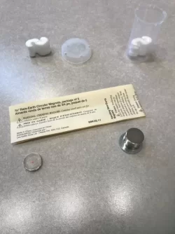

Update to the above: I plan to do this small project today.
The planned Hyundai magnetic drain plugs turned out to not be magnetic, so I will be using rare earth magnets placed on the outside of the current drain/fill plugs.
In this shot, this is the closest one of the magnets can be placed next to the remaining stack due to the repulsive force between like poles:
