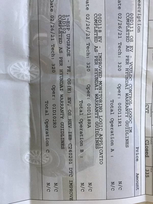

We received, in the mail, as recall notice for the brake software.
When I called the local dealership to book the appointment, the chap told me three updates were outstanding.
My wife took the car in this morning and was there for 55 minutes.
Here is a screen shot of what was done (sorry about rotation):

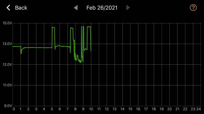

I left the 12 volt battery monitor in place during the service visit:

Too bad the work order is in code. It would be nice to know what work was done and why. I just got the brake recall letter this week too. I'll get it done when I swap tires out in April. And maybe I'll be doing the battery swap-out when I change tires again this coming November?! ;)
Hopefully by then, there will be a foolproof procedure to do a swap in one day without drama.
