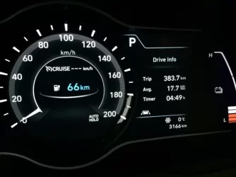

When we got home, we had 20% remaining (50% used for the return trip):
The conditions were no wind, -1C, mostly bare and dry roads and a speed of 90 kph.
So, "102%" of capacity got us 383.7 km:

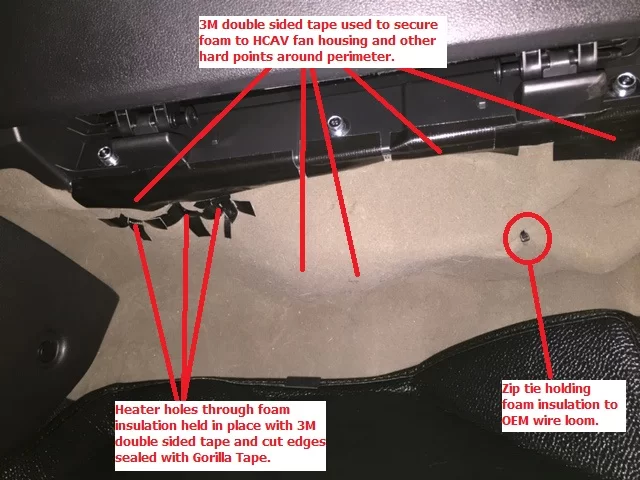

1. The foot well area of the front passenger seat has cool air intruding at/around the shroud that houses the HVAC fan. I am contemplating fashioning and installing an ad hoc insulator to block this cool air. The HVAC was producing the correct heat and one could feel the heat being discharged from the appropriate heater vents just below the glove box, but the area next to the fire wall was definitely cold. Is this common with these cars?

I'm still thinking this one out. I suspect I will build an ad hoc shroud to insulate that whole housing that holds the HVAC fan. I'm almost thinking, because this is a heat pump system, that some portion of the system that becomes the suction/low side (when asked to heat me instead of cool me) is "conditioning" the airflow prior to the HVAC fan and evaporator core. The whole housing just feels cold soaked. I must think on this for a few days...

I'd like to re-visit my back of napkin numbers regarding what the usable capacity of the battery pack may be.
Yesterday's trip figures:
We left home with 100% SOC. We added 22% SOC at the charger. We arrive home with 20% SOC.
102% of available capacity was used.
Using the odometer figures (383.7 x .177) I get a total of 67.9 kWh used (for 102% capacity).
This maths out to 100% equaling 66.6 kWh...

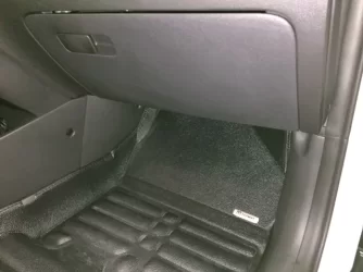

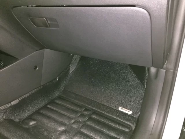

Here is my solution:
I took a de-commissioned padded workout mat and after some rudimentary measurements, cut it and installed it in place as shown:
It is friction fit behind the center console side trim, the top edge of the floor pan carpet where it meets the fire wall and behind the outboard kick plate trim.
It is suspended in place using 3M double sided automotive trim tape and various hard points including but not limited to the frames of the holes for the heat duct outlets, the HVAC fan shroud and the structural metal bar at the base of the glove box.
Nothing is seen from any normal perspectives:

My back tells me you must have had a fun time getting in there :eek: let us know how well it solves the issue.
