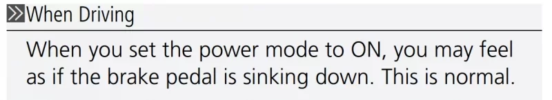

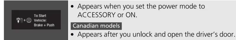

Also it's not clear what they mean in the brake fluid document by "the ON mode". In the Clarity owner's manual it sometimes uses ON capitalized to indicate pressing the power button twice without pressing the brake pedal. ON mode runs off the 12V battery, and it's even more battery draining than ACCESSORY mode because the entire 12V system is powered up including all of the dash lights, and also the DRL's which would really drain the 12V battery unless you use the parking brake trick to keep the DRL's off.
For a lengthy procedure like brake fluid change it would be preferable to be in READY mode to avoid running down the 12V battery like you would in ON mode. Maybe that's what they meant, after all even the owners' manual is inconsistent with this term. In some places it uses ON to refer to that specific mode, for example:
But then in several other places it uses the term ON mode when the context appears to be READY mode, like in this example:
It's really a shortcoming in the owner's manual that it is not consistent with the use of this term because it's such an important distinction between ON mode and READY mode.
