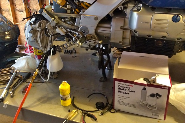

2) I have a Harbor Freight vacuum brake bleeder that hooks up to an air hose to suck the fluid out from the bleed screw. Shown below doing the deed on a motorcycle. Any reason this wouldn’t work in place of pumping the brake pedal?

I have a vacuum pump bleeder too. But I dont think that will work for our car since there are 2 distinct system. I have to agree with others that there must be a good reason why Honda instructions specified pumping the brakes instead of vacuuming it out. Pumping it required 2 people which would cost dealer extra $$$ for the procedure.

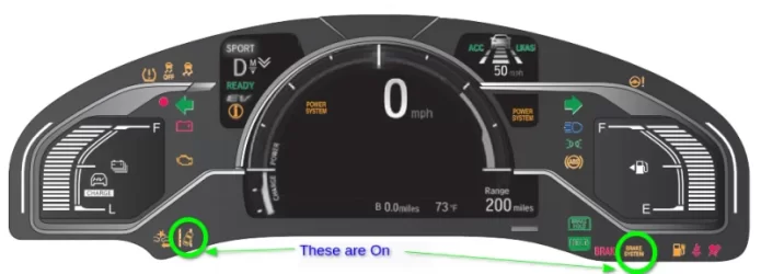

When done, there are now several warning messages (RDM, ACC errors, and the "Brake System" indicator is on too). I was certain that I did everything properly, and never ran anywhere close to low level in the master. Reading the procedure again, it states this:
"Because brake fluid is replaced with the vehicle in ON mode, the brake system indicator is turned on. The brake sytem indicator goes off by depressing the brake pedal for about 3 seconds".
I was hoping that the RDM and ACC errors were related to the brake warning indicator. So, I did the 3-second thing, crossing my fingers. No dice however. The "Brake System" indicator remains on continuously. I am not sure what to make of this. The brakes are functioning normally from what I can tell. The master cylinder is full. I am not sure how RDM and ACC could be related. Lacking a better idea, I tried the "cold boot" disconnecting the 12V battery, but the problem persists. @Clarity_Newbie - I assume you didn't encounter this with your vaccum method (presumably because you weren't replacing fluid with the vehicle ON?)
To be clear, these are the warning indictors that are now on:
Suggestions are welcome... I will post any progress with this one.

Does the OBDII port shed any light on the problem? Can it reset the warning indicators? Would you feel comfortable if you reset the warning indicators and they didn't come back on?
Haven't tried that, but it is on my list. Yes, I would be comfortable if it cleared and didn't come back. My comfort comes from the fact that the procedute states that this light was expected to come on. Just can't figure out why the 3-second brake depression won't clear it...
