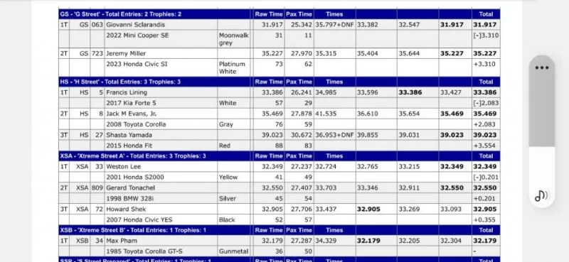

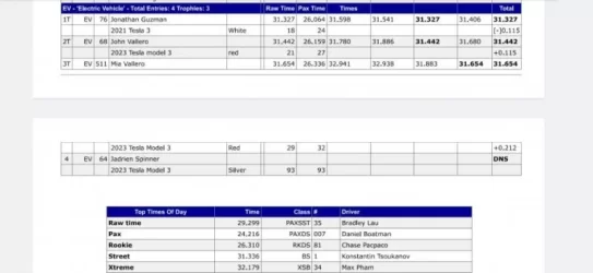

Are you within 1/2 second of M3Ps? They are crazy fast. The tight event a M3P set FTD (no karts). I merely beat most of the Miatas and all of CAM-C :-D. RWD Model 3s I sometimes beat.

Thanks for the advice. Yes, they're all MP3 versions. Here's last week's results. Screenshot_20230827_122220_Drive.webpScreenshot_20230827_122143_Drive.webp
