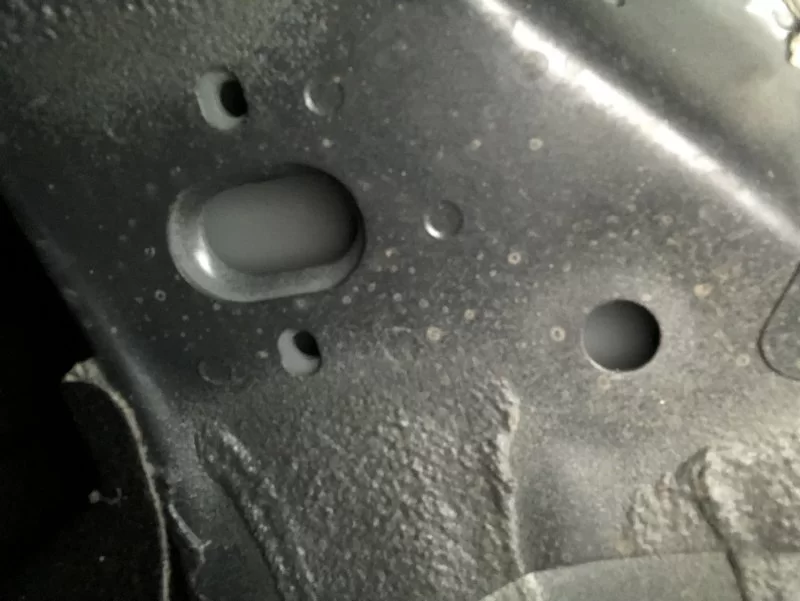

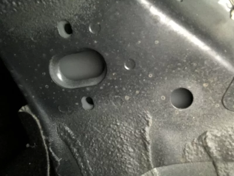

Hello all, just when you thought you had heard it all about the 'plugs'. Took it to the dealer to fix the HV mileage(success), A-pillar rattle(so-far-so-good) and put in the 4 body plugs. Got home and looked more at the invoice and saw "missing plugs, installed 5 plugs in rear of car". ??5?? I went out and checked the 4 holes we have been talking about and sure enough, no rubber plugs. After a call with the somewhat confused service guy I am going back by tomorrow for, supposedly, the correct plugs. Hard to be too mad at the guy, he gets back to me quickly and doesn't guess, if he doesn't know he says so and he finds out(rare today). He said they will install them as soon as I get there so I don't have to wait. Question is does anyone else not have these plugs? Maybe these holes in the back do not have plugs normally and the tech saw the holes and just starting putting plugs in without looking at the PDI document(I am afraid this is probably what it is) for where the plug should go. These is nothing in the PDI about any other plugs so these hole plugs would have to be a factory task. Anyway here is a photo of the back part of the car where I assume the new plugs are, I do not have a 'before' photo.

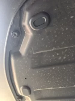

The PDI only specifies 4 plugs that are oblong ovals like one of the plugs in your picture. It doesn’t say anything about a 5th plug. The locations are inbound of the 4 wheels with the front ones being about 6” from the side edge is the car.

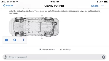

Here’s is diagram from the PDI:

Now I are worried the dealer is just putting plugs in random holes. I would love it if someone would hold their phone under the trunk area and snap a picture and see if the holes plugged in my photo have plugs in your car(s).
While the garage was cool this morning, I got down and looked under the trunk area shown in your picture. There were no plugs in any of the 3 holes on the passenger side and none in the 2 holes in the driver side. So those plugs don’t appear to belong there.
The 4 oblong oval plugs go into the 4 holes located exactly as shown in the diagram above. Take that diagram and show your dealer who evidently doesn’t care enough to follow the instructions of or even read the PDI which Honda pays them 1.4 hours to perform.
I would be very leery of randomly plugging holes under the car. Some are there to allow water to drain away and some are there that need to be plugged to keep water and noise out. Not knowing which is which can potentially lead to problems later on.
The front plugs are about 6” inside the back front wheel well and the rear plugs are right behind the rear lift points where you see a short 90 degree angled piece of steel has been welded to support a jack. The PDI does not mention any other plugs to install.

Bad lighting and maybe looking at the wrong holes; mine does actually have four plugs when I went to take pictures with a flash.

4. It says to install 4 body plugs (under car just behind front wheels and just before rear wheels and has a picture). It says “they are part of the noise reduction package and play a big part in reducing road noise”. I checked my car and they were not installed! I have my dealer ordering them now. So I have little faith that the pre delivery inspection was done correctly. You might want to check your Claritys for this. They fit in oblong oval holes (maybe 1x2”) about 6” from the edge of the sides of the car.
