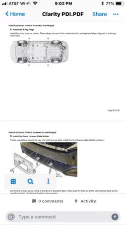

Thanks to @Atkinson for sending me a treasure trove of docs he found on Honda Tech. The best of the lot is the attached Pre Delivery Inspection (SB 17-093) that lists a lot of info not previously sourced on the forum.
Here are some of the highlights:
1. We finally have a documented metric on when Honda will replace our batteries. It says this will be a warranty covered replacement when the battery degrades to less than 36.6 Ah. The original capacity is ~55 Ah so we get a battery replacement under warranty after losing ~1/3 of our capacity or range. Note that the car will NOT throw a diagnostic code for this. The only way to know is to go to the dealer and have them check the Battery Pack Capacity signal with their i-HDS. Or wait until ScanGague and our beta tester, @AnthonyW gets it working.
So 33% div by 8 yr warranty = ~4% loss per year worst case. That’s pretty good and even better in Cali w their 10 yr warranty.
Some of you EE guys please check my math and assumptions here.
2. It has pix of 2 jacking points (rear at center tie down and front on casing in a triangular opening just behind the center line of the front wheels). These are how you jack the front or rear end (both wheels) off the ground. It also shows the 4 lift point on the sides where you can see a welded angle piece. And cautions against lifting anywhere else.
3. It says the dealer is to charge the HV battery but explicitly says NOT to use the customer’s charging cable. This may explain why a lot of dealers are not charging their Claritys. They’re too cheap to buy a charger. (Not going to get into the stupidity issue!)

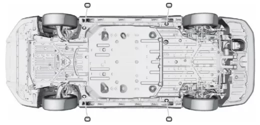

4. It says to install 4 body plugs (under car just behind front wheels and just before rear wheels and has a picture). It says “they are part of the noise reduction package and play a big part in reducing road noise”. I checked my car and they were not installed! I have my dealer ordering them now. So I have little faith that the pre delivery inspection was done correctly. You might want to check your Claritys for this. They fit in oblong oval holes (maybe 1x2”) about 6” from the edge of the sides of the car.

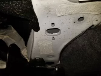

I dont think I have the plugs
I definitely don’t have the plugs. Thanks for sharing. This could explain why some people think the ride is quiet and others complain of road noise.

If I have it correctly, they are oval black plastic snap-in pieces in the location indicated by the diagram in the PDI doc.
The two front plugs are more inboard than the rears.
I pulled one off and put it back in.
Hoping someone can confirm I have the right parts.
JCEV, I get your question - I spent about 10 minutes second-guessing if I had it right.
Here’s a picture of where they are.
“8. Install the Body Plugs Install the body plugs as shown. These plugs are part of the noise-reduction package and play a big part in reducing road noise. “
Based on this, if you don’t have them, I’d get your dealer to order them. I did and parts dept said no problem. They said they would come from a warehouse in Cali and take a week to get in. I’ll post if they make any difference.
