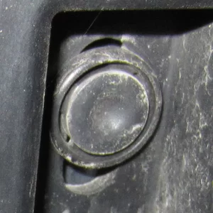

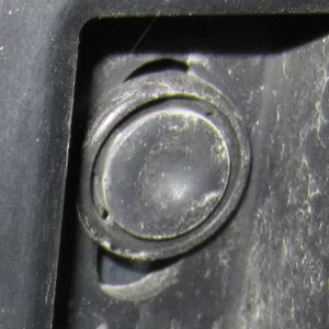

I held my camera under the rear end of our Clarity PHEV and was flabbergasted at this photo. Not a square peg in a round hole, but similar! This explains why I have just a little road noise.
Lol, at least they knew they lost something... Those look like random 25mm body plugs from a Civic or similar.
I have the same thing but that is not the right hole. The front ones are easier to see. Here is a picture of one of the rear ones. My phone has a wide angle lens. It is right behind the silver metal piece. I reached my hand behind the piece and felt the hole. I don't have the plugs.

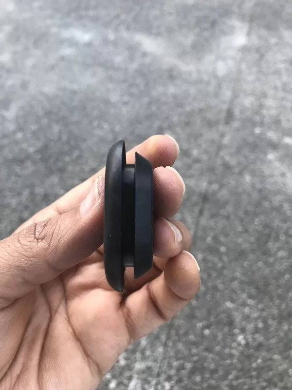

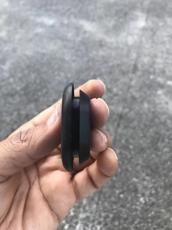

Was anybody able to DIY install the plugs? It seems like they need to go in from the wide side? (left side in image) I was unable to push them in, my dealer is 75 miles away so may go to a local dealer tomorrow
Was anybody able to DIY install the plugs? It seems like they need to go in from the wide side? (left side in image) I was unable to push them in, my dealer is 75 miles away so may go to a local dealer tomorrow View attachment 1860
Never mind, the narrow edge goes in first, took a bit of pushing. Also realized I have these for my 2012 Sienna, they were in the glove box for 6 years, hopefully some lesser road noise in the future.
My dealer installed them by spraying a little silicone lube to help them go in easier. Learned a new trick watching that.
However, they don’t seem to reduce noise as much as the PDI doc seems to say they will. Perhaps I’m hearing a little less road noise at speed on rough pavement but it’s a very subjective observation in a car that’s already very quiet. But overall not very much of a difference.
