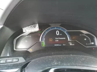

I'm just purchased a 2018 Clarity on a Auction (I didn't pick up the car yet) with a minor to moderate front damage. No airbags deployed! Before that, I was looking Claritys on the web and I just found another 2018 with 206k+ miles. Yes!, 206000! I uploading a pic to show you it.
Hi. About your question, it is a HONDA! ; D

Would be interesting to know what the battery capacity was on the 206,000 mile car.
On that topic, we have people come on here sometimes who are looking to buy a used Clarity, might be worth suggesting to them that they purchase a $30 VGate iCar Pro BLE 4.0 OBD-II reader and free Car Scanner app to take with them when they check out prospective cars. Battery capacity would be valuable information to have prior to purchase. And even if they don't wind up getting a Clarity they can use the OBD-II reader on any car if they didn't have one already.

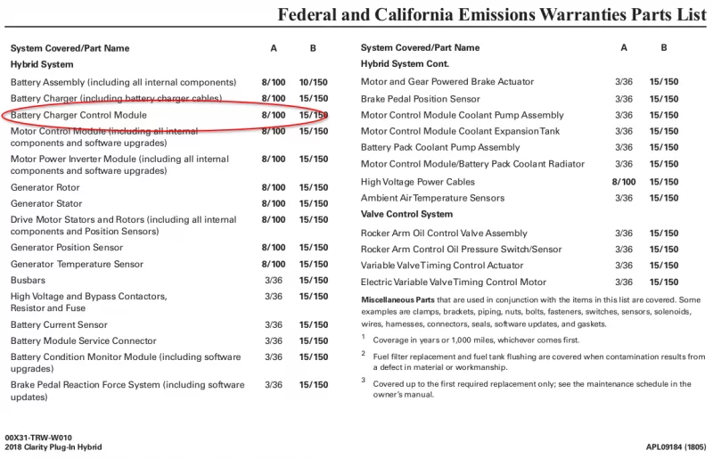

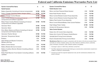

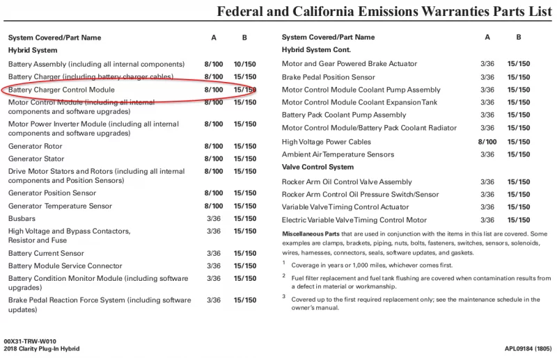

Here is the relevant page from the warranty manual:
Previous owner said he couldn't get Honda to pay for it. That's why he traded it.
And I would think the dealership would have thought about that over the three days this was going on. No one wanted me to keep the car more than they did.
I appreciate that screenshot though. Maybe it can help someone else.
"I was told by Honda America that my vehicle was not under warranty and that because I didn't have an extended warranty that there was nothing that Honda could do."
You are probably sick of it by now, but this is a totally unsatisfactory answer.
The screenshot is from the official Honda warranty document. I can attach the whole thing, but perhaps it is moot now.
They need to explain why it is not covered when it specifically states that it is covered in their own warranty document !
