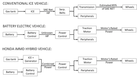

It would be more helpful if you would accept that the 212 HP figure is "sticking with the original way." That way is now, and always has been, an incomplete description. It means the power that the car can extract from fuel and/or battery. The problem is that this is now, and (again) always has been, determined before that power is divided between various systems, and before it is subjected to various losses.
The 181 HP figure, which has nothing whatsoever to do with extracting power, is the more descriptive and useful figure. Because it describes only what can be applied to the road, after power is divided and after almost all of the possible losses. And it represents a quantity you have never been told about before; definitely not "the original way."
All the 85% estimation I've described is about, is Honda say "Yes, we can extract enough power to fully provide for this more useful number, in addition to those other sources and losses. But if you want a number that compares to 'the original way', it is 212 HP."
I accept that the 181hp electric motor can produce 212hp for brief periods of time from the current, provided simultaneously, from both the battery and generator. This liberates me to waste my time on more important matters.
No, the electric motor is rated at 181 HP, and that is hard limit. I don't know whether it is the maximum input, or the maximum output, but it never exceeds it.
I think I figured out what makes this hard to understand. The analogy for the electric motor is not the ICE in and ICEV. It is the transmission. An engine produces power from a stored source of energy. Both a transmission, and an electric motor, transform that power in some way and transmit it to another device.
So in an ICEV, the ICE produces power from gasoline, in the form of a rotating shaft at some RPM. It is the battery, and its controlling electronics, that "produce" the electricity in a BEV. The ICEV's transmission transforms the ICE's RPM into that of the wheels, and transmits most (but not all) of this power to them. In a BEV, the traction motor turns most of this power into mechanical power, and transmits it to the wheels. Here is a simplified diagram:
In the conventional car, the only power figure we know is the maximum output of the ICE. It is called SAE Net Horsepower. The estimates that I have seen say that 85% of that can reach the wheels, but that is only an estimate. In truth, we don't know what it is.
In the BEV, the only number I have seen published is the motor's rating. This is probably because the Battery Control and Power Control are really parts of the same overall device, so there really is no point where the amount of power tat is actually "produced" can be measured. So I'm treating it as analogous to the output of the motor here, mostly because it makes the three diagrams line up nicely.
In the Honda iMMD hybrid, we know the motor's rating the same way we know it for a BEV. But this is not power being produced, it is the portion of the power produced by the battery and the ICE that reaches the motor. And again, Battery Control and Power Control are the same device. So again, there is no point where this power can be can be measured. But, if the peripherals and losses are comparable to those in an ICEV, then we can estimate the maximum combined power we need by (Combined Power) = (Motor Rated Power)/0.85.
This does not mean the two sources are limited to this number, any more than a BEV's battery is limited to the power that its battery and peripherals can take. It means that the system is capable of that much. This is why the Accord and Clarity have the same combined power.
I’m sticking with my statement, as there’s less speculation involved than anything else that’s been presented.
That is complete speculation. There is absolutely no evidence that the motor can handle more than 181 P. But then, you probably have not seen the quote from Takeshi Wakamatsu, a head engineer at Honda and lead author of the paper "Development of 2.0 L Engine for the New Accord Hybrid." He said "only 181 HP can come from the traction motor." That seems pretty definitive.
Comparisons between ICE, EV, and hybrid are inherently problematic.
That's why I said the diagrams were simplified, and made it clear which numbers were estimates.

Here's a step-by-step, generic description:
  1. The car has reservoir, where a substance with chemical, potential energy is stored.
  2. There is a device that I'll call the power plant that releases this energy, and creates a flow of energy that is called power.
    1. Some gets used for purposes other than propulsion.
  3. There is a second device that I'll call the transformer that alters the leftover power into the form used by the wheels; that is, a torque at the RPM of the wheels.
The "power produced" is the power created in step #2. The "propulsion power" is taken from step #3, RPM*Torque*conversion_factor.
  • In an ICEV, the maximum "power produced" is measureable quantity, called SAE Net Horsepower. Maximum "propulsion power" is not known, because it depends on the efficiency of the transformer and parasitic draws for peripherals.
  • In an EV, the maximum "propulsion power" (or something very close to it) is determined by the rating of the motor. There is no evidence that this rating is exceeded.
    • In a BEV, one would expect that the battery system is capable of providing this power, plus whatever is needed for peripherals, and any losses.
    • In a serial HEV, it is the generator and battery combined.
I'm guessing that you are talking about the transmission again? If so I would not say that the transmission alters the power into the form used by the wheels. However next to it are some parts that do, the piston rods and the crankshaft. They convert the pistons' linear kinetic energy, which is unusable by the wheels, into the rotational kinetic energy that the wheels need. The car would be undriveable without this alteration of the power by the piston rods and crankshaft.
Yes the transmission alters the power also, by altering the gear ratio within a range of high power/low speed to low power/high speed. However this is more about efficiency and drivability, as an ICE vehicle can in theory operate with just one gear ratio, although it would not be very efficient or enjoyable to drive. So by all means the transmission is important, but if we are going to pick one section of the drivetrain as being the place where the power is altered into the form used by the wheels, I nominate the piston rods and crankshaft.
In the case of an EV or serial hybrid, the kinetic energy produced by the traction motor is already rotational, so it doesn't need to be altered. In fact it also doesn't need any alterations to the gear ratio to be efficient or drivable, which is why EV's don't have a transmission in the traditional sense, not even a CVT. Honda calls the Clarity "transmission" an eCVT, which is a name apparently designed to sound somewhat familiar to the typical car buyer, even if technically the name doesn't really make any sense.
Some exceptions - the Porsche Taycan has a two-speed gearbox for increased acceleration and higher top end speed. And interestingly Kia and Hyundai PHEV's run all of the power through a six-speed automatic transmission even while driving in EV mode.
This is just a matter of semantics, and you seem to be taking a far-too argumentative stance about it. I choose to call a change from 200 lb-ft at 1000 rpm, to 100 lb-ft at 2000 rpm, an alteration of the form of power. I choose to do so only to create a placeholder in the analogy, for something that does exist in the EV. Even though it is not necessary for the analogy.
You don't choose to do so. That's fine. The traction motor in an EV still fulfills the same primary function as the transmission in an ICEV. Neither "produces" power. They take, as an input, the power that is produced (A) by another device (B) from stored chemical energy (not power), (C) massage it into the correct form power as it can be used by the wheels, and (D) pass it along the the wheels.
The point being that the capabilities of neither the transmission, nor the traction motor, have anything directly to do with the power that a car can "produce." But they have everything to do with what power can be passed to the wheels.
In an ICEV, it is the engine that "produces" power from gasoline. This power stream gets split, so that some can be used by peripherals. What's left becomes the input to the transmission, where the rpm of the engine is to be changed to the rpm of the wheels (with P_OUT=EFF*P_IN). The maximum power that can reach the wheels is, simplistically, the power produced by the engine, minus the power pulled off for peripherals, minus the losses in the propulsion path.
The issue here is that only the engine's power is published. All the other numbers are estimates. One I have seen used is (Max Propulsion Power)=0.85*(Max Produced Power).​
In a BEV, it is the battery (and controlling electronics) that "produces" power from lithium ions. This power stream gets split, so that some can be used by peripherals. What's left becomes the input to the traction motor, where the electric power is changed into (torque)*(rpm of the wheels). The maximum power that can reach the wheels is, simplistically, the power rating of the traction motor. But to get that, it needs the battery (and controlling electronics) to produce this power, plus the losses in the propulsion path, plus what gets pulled off for peripherals.
The issue here is that (AFAIK) only the motor's rating is published. Any other numbers would be estimates.​
ICEVs publish only the power that the ICE can produce, because they can't know the missing details. A Tesla Model 3, single motor, is rated at 211 kW. That's the motor's rating. I don't know if they publish the battery's capability. You might be able to find it, but it would be unethical to publish it as a rating for the car, since the car can't use it all at a time. But to use that motor to its full capability, the battery needs to be capable of producing something like 250 kW, so that 39 can be budgeted for peripherals and losses. That's probably a little pessimistic. But you know what? I don't care. This is only a mental exercise. And I'm sure that a Tesla's battery can produce much more if they are taken out of the car. But in the car, they will only produce what the car can use.
Honda publishes both numbers for iMMD hybrids. The 181 HP is the Accord's and Clarity's traction motor's rating, and it is not ever exceeded. In order for the battery+generator to be able to supply that 181 HP, it needs to produce a little bit more so that some can be pulled off for peripherals, and to account for losses. It isn't an exact number, but the spec is 212 HP since that uses the same estimated numbers that an ICEV uses. But this is a spec - the system needs to be able to produce that much. Honda publishes it only because it provides the best comparison to the power of an ICEV.
