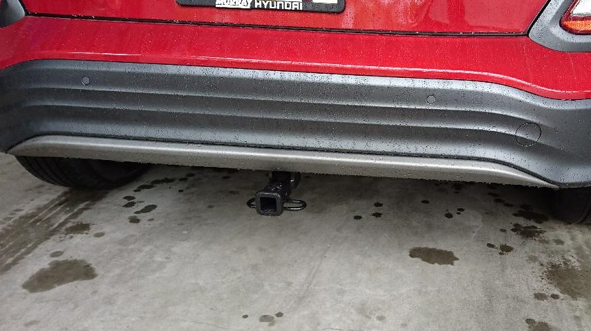

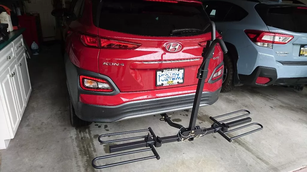

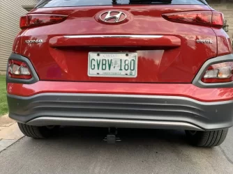

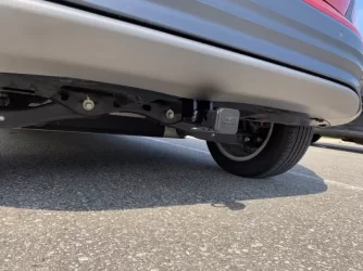

R P, would you mind posting a picture of the hitch
R P, would you mind posting a picture of the installed hitch? I'm looking for one that just shows the receiver as you described.
Here you go... Also, if you click on the installation guide link, it will show you the complete detail pic of the hitch.
Looks fantastic!

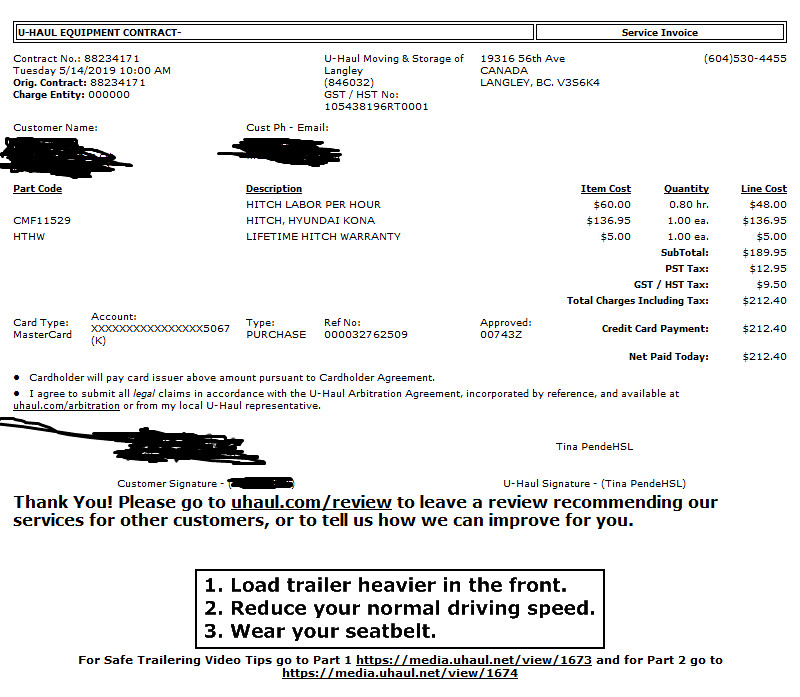

What's the final damage - hitch and installation total?

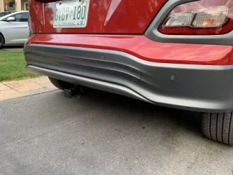

Does the hitch get hidden under the cladding with the cut out?
Was thinking of ordering the curt and doing it myself but this actually looks a lot cleaner to be honest. I don't like how the previous curt install left some gabs in the cladding and it didn't seem to "close up" nicely. I want the hitch to look like it came from factory.

Here's the inv copy. I usually install hitches myself, but this one required some customization on the EV model, so was glad to let them do it. They did a nice job though, with cutting out the plastic only as required to make a nice tight clean job.

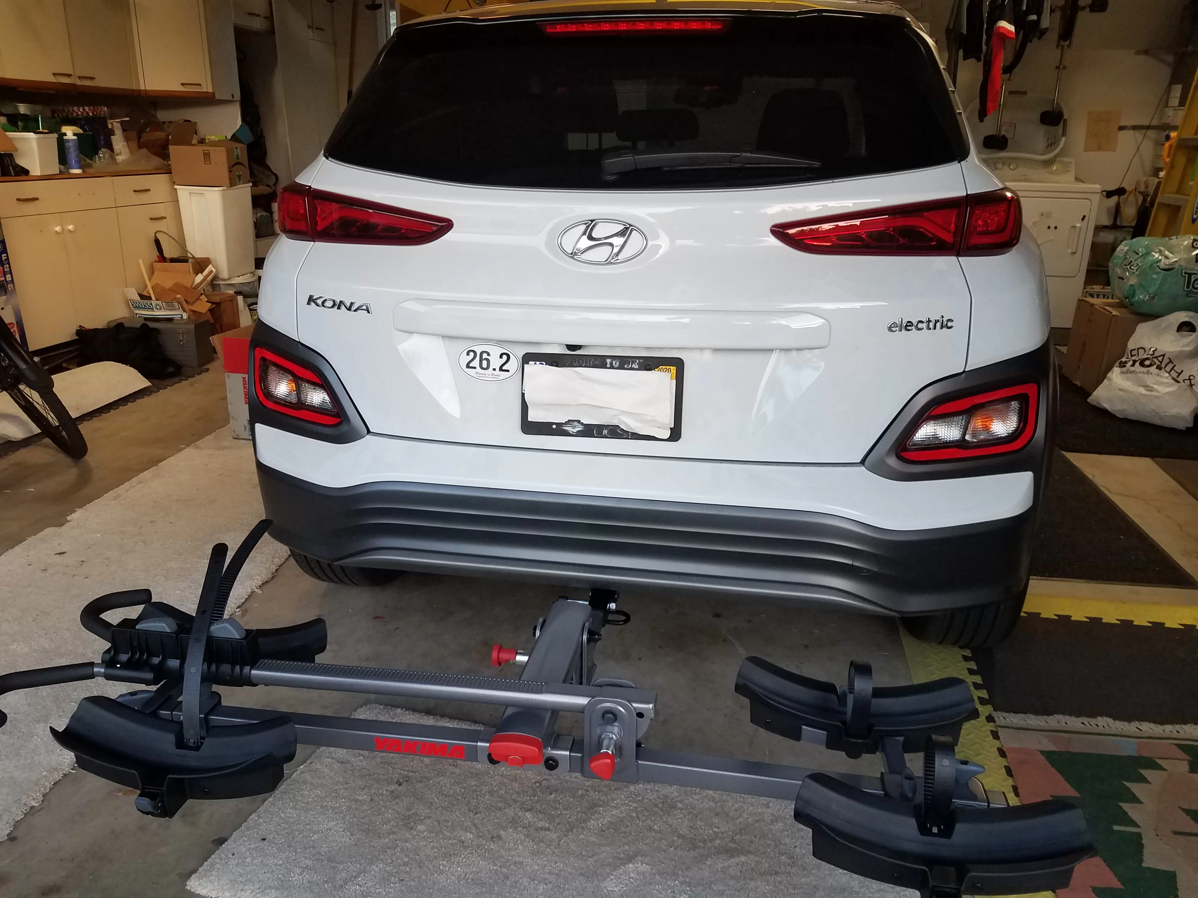

(2) 7/16 bolts at each end through a single wall of the tube framing member. Each tightened to 50 ft-lbs. Seems very solid with no motion when I installed the bike rack.

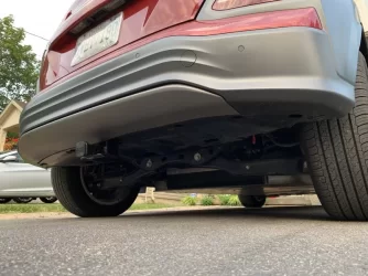

I'd like to give a big THANK YOU to Dag Lindquist. I provided your photos with annotations to San Diego Trailer Supply. They installed the Draw-Tite #24976 on my Kona Electric yesterday. I installed a Yakima Two Timer rack. If you are in the San Diego area and need to have this done. Contact Big Dave or Greg at San Diego Trailer Supply.

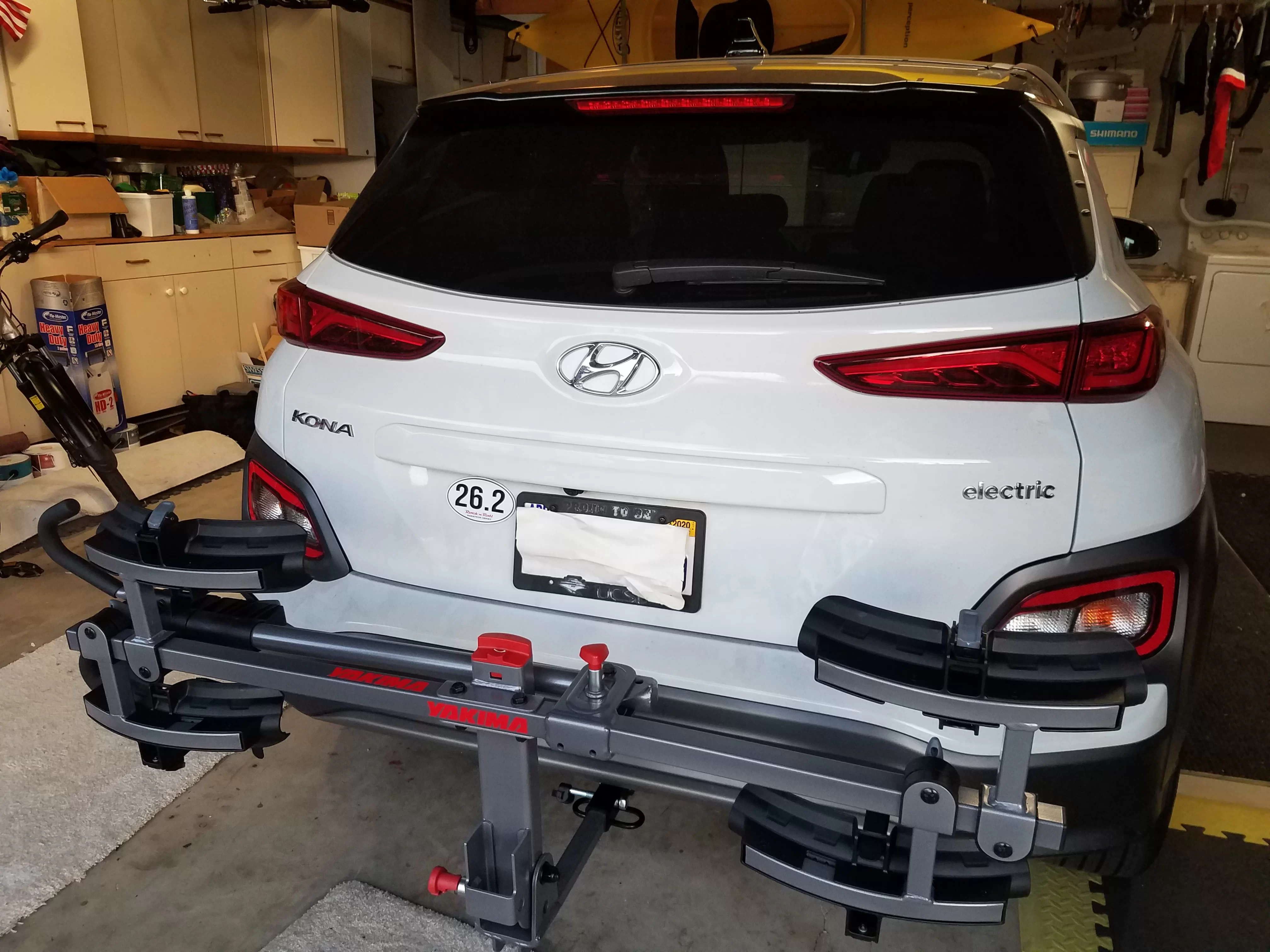

Thanks to al you early adopters for the info, I am about to do this as well. A couple of questions:
What happens to the parking sensors when you mount this, do you get alarms when the rear bumper "sees" the obstruction of the rack?
Also how badly does the rack block your tail lights from other cars seeing you are braking?
We have a lot of bumper to bumper traffic and I just see myself getting rear ended from lack of visibility.

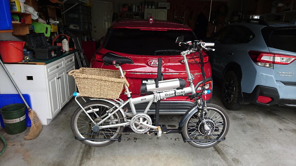

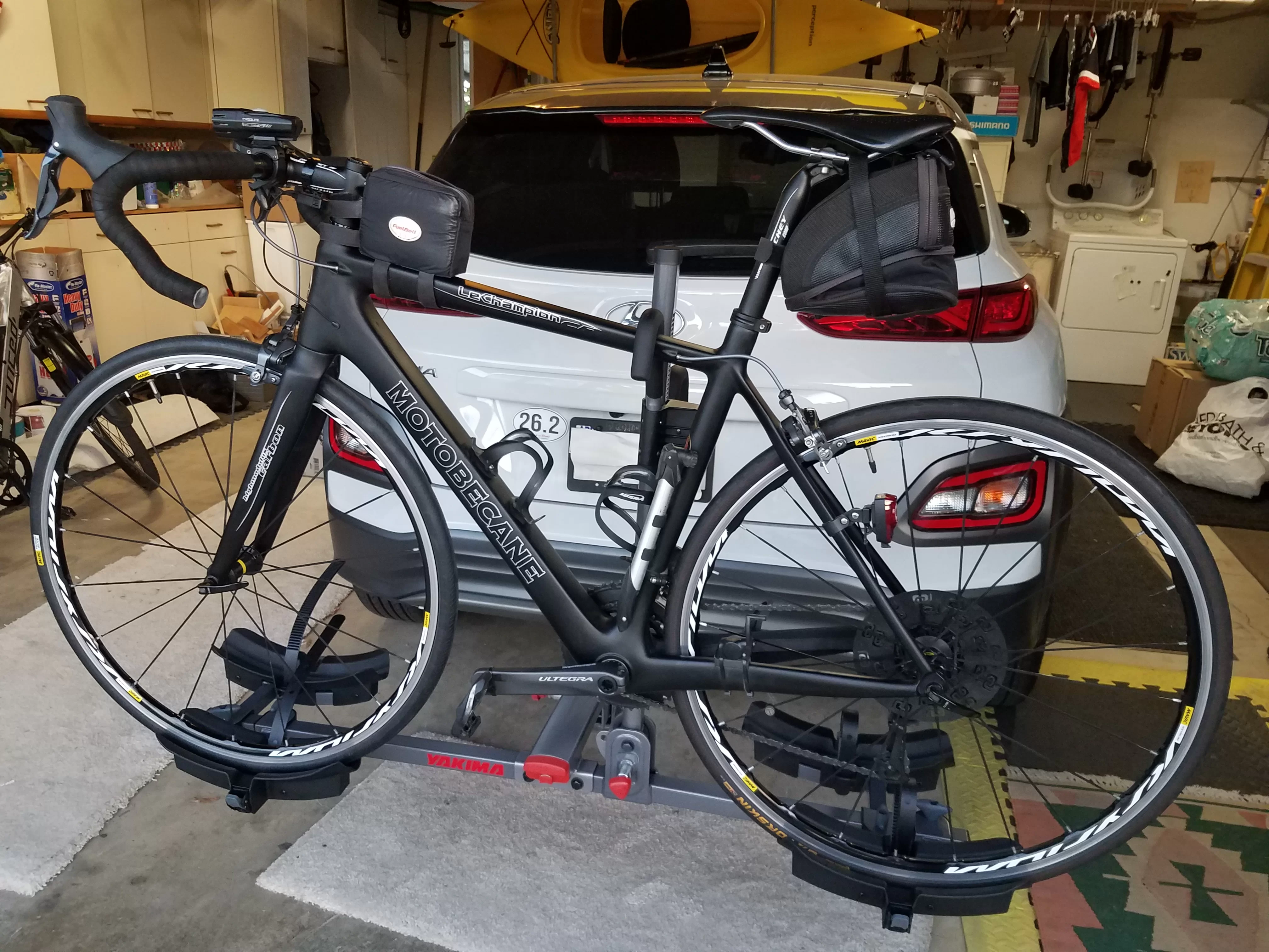

Great questions. None of which I have an exact answer for. Here is my speculation. Light from brake lights will not be fully obstructed unless you are carrying a wall on your bike rack. The rack itself is mounted below the level of the lowest light and the Kona has lights at 3 levels. Light will easily pass through spokes, rims, frames, etc...
Sensors usually detect change over zones. Since your rack and bike(s) are stationary, I doubt that the sensors will 'see' them. It is possible that a sensor may become slightly blinded by the rack or bike(s). I plan on using traditional driving techniques, aka Looking over both shoulders.
The backup sensor on my Kona basically lets out a constant tone when in reverse while the bike rack is installed into the hitch receiver. It's not a huge deal though as I don't do much driving in reverse other than backing out of spots.

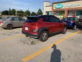

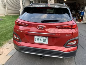

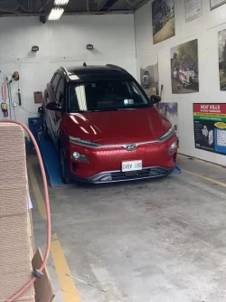

I finally made it out to our local UHaul trailer installation centre to have my hitch installed!
They did a phenomenal job on the installation. It's very clean and looks factory-installed. I'm extremely happy with the outcome!
Total cost was only $210 CAD. I found this to be extremely reasonable.
