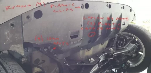

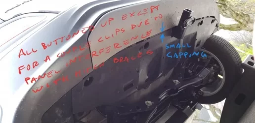

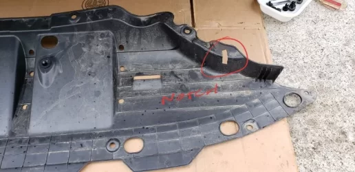

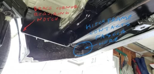

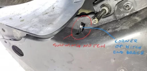

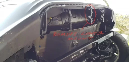

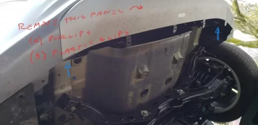

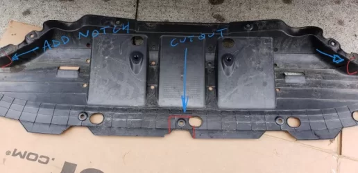

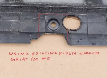

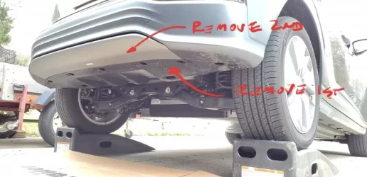

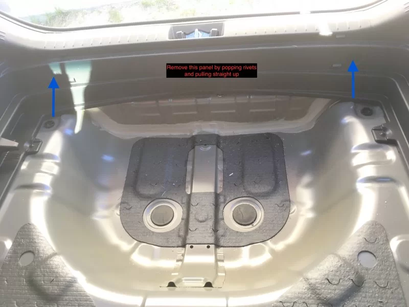

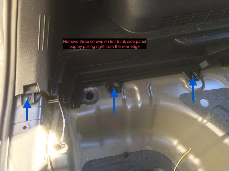

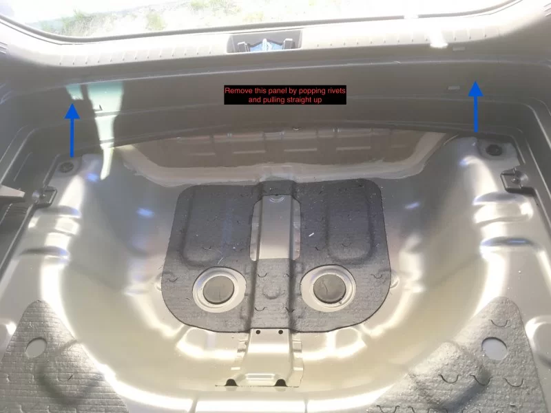

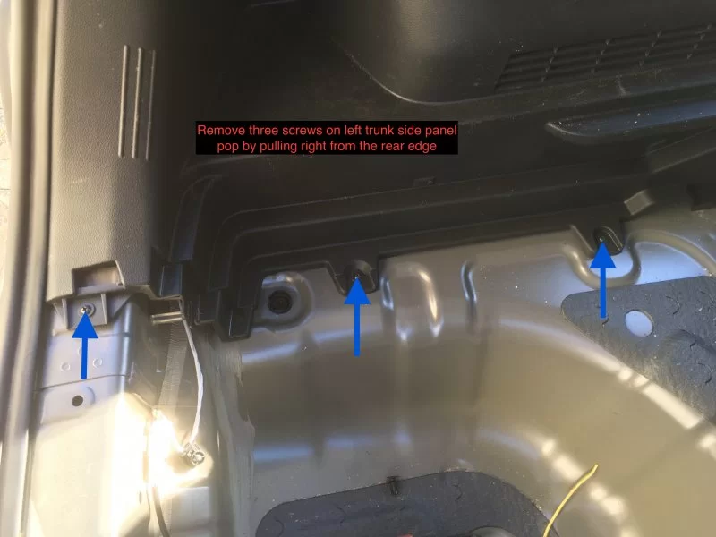

Here are annotated pics from installation of the Draw-Tite #24976.
Looks generally similar to the Geoff's Curt install. Interference prevented the removable panels from fitting tight. Will need to implement Geoff's fix of removing some the plastic screw mounts. See pictures for clarity.

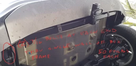

Did either of you take photos of the actual hitch attachment point at the unibody? Interested as to how the fasteners attached and how tight they could be.
Also if the attachment appears plenty strong regarding the long moment arm of the bike carrier.

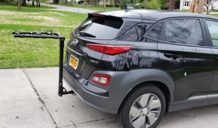

(2) 7/16 bolts at each end through a single wall of the tube framing member. Each tightened to 50 ft-lbs. Seems very solid with no motion when I installed the bike rack.

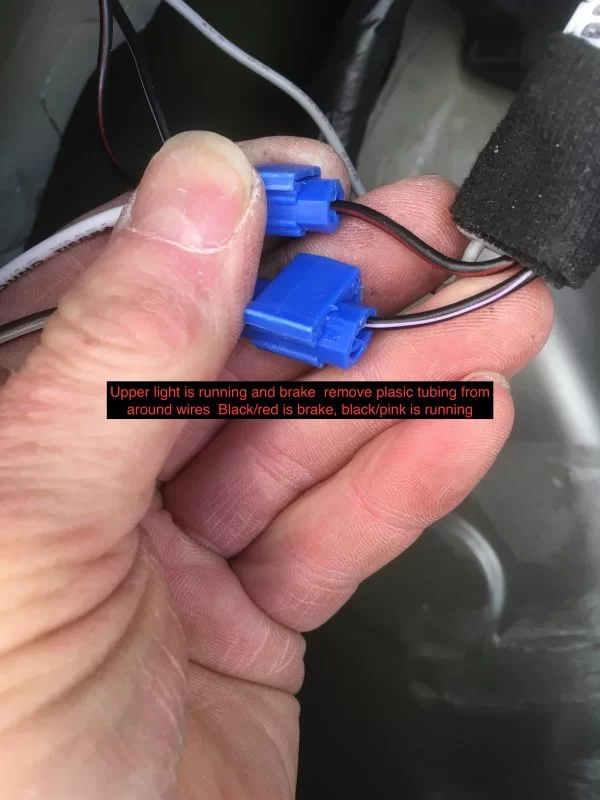

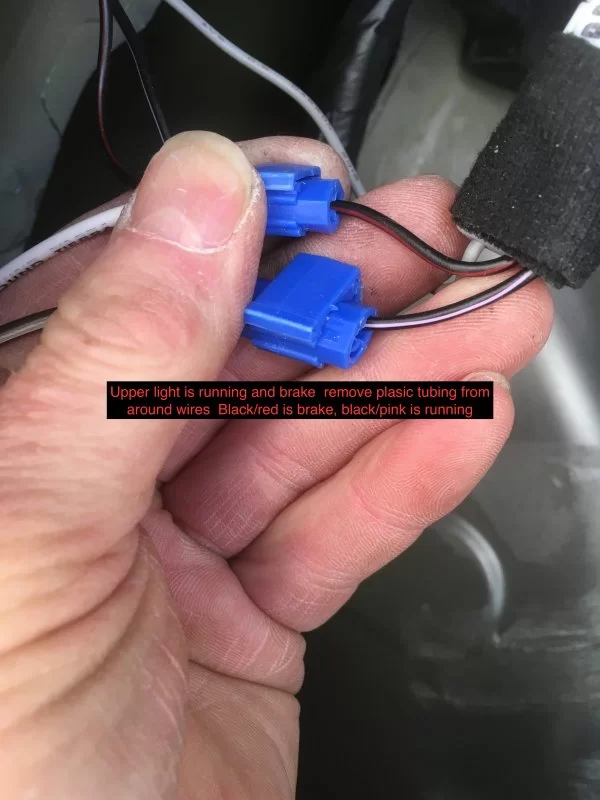

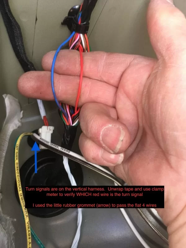

OK the $15 Hyundai wiring harness part number 57314-001 from eBay works without a problem.
Had to take power off 12V battery (fuse at battery!) and fed down to the extruded aluminum side rails of battery pack. Then through the side rails and back to the rear subframe. There are no good places to use wire ties between the end points, so I relied on a certain amount of tension.

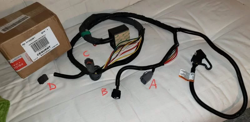

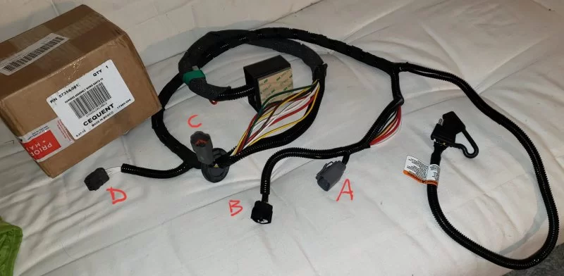

Hello Geoff,
I bought the 57314-001 harness off eBay but it appears different than yours which from your pictures had some printed labeling on the wires. Mine does not (See picture). I'm thinking the inputs (+12, gnd, turns, brake and running) can splice into wires on the harness leg going to the connectors that I've labeled A & B and that connectors C & D go unused. I wasn't able to find any schematics or other details on line anywhere. Any pointers you can offer would be great. Thanks!
Harness is next...
It should work. Just some wiring details. And routing a wire all the way to the 12v battery. Stay tuned.

Hello Geoff,
I bought the 57314-001 harness off eBay but it appears different than yours which from your pictures had some printed labeling on the wires. Mine does not (See picture). I'm thinking the inputs (+12, gnd, turns, brake and running) can splice into wires on the harness leg going to the connectors that I've labeled A & B and that connectors C & D go unused. I wasn't able to find any schematics or other details on line anywhere. Any pointers you can offer would be great. Thanks!View attachment 4716
Update, I figured out my questions and the 57314-001 harness worked out great! I'll more details soon.

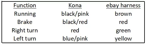

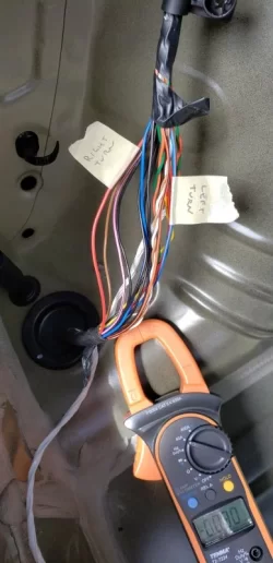

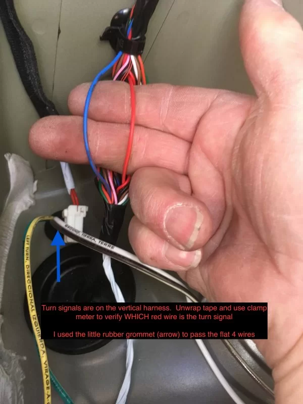

The $15 Hyundai wiring harness part number 57314-001 off ebay is a great deal. It includes a powered converter that powers the trailer lights so the Kona wiring is isolated. I started with Geoff's May 3rd post (#19). All the wires can be accessed in the drivers side rear corner. The ebay harness has some extra bits to remove: Cut back the tape and wrap from connectors A and B back to the trunk (see labeled picture). Similarly free up the harness to C and D. Cut off the rubber grommet and remove it along with C and D. Those are used as some sort of replacement pass thru on the Santa Fe install. Connector A is power and ground for the converter. Those I butt spliced to wires I ran to the battery also using the drivers side battery mount extrusion to run the wires. I then tie wrapped these to some brake lines. I know I could use the car frame for ground but ran a wire anyway since I had plenty. I put an inline fuse by the battery for the 12v line. Harness connector B holds all the signal inputs for the converter. A multimeter with a clamp for DC current worked great for identifying the turn signal wires which were on the vertical Kona harness. Brake and running light inputs from the upper harness. I used small gauge quick splice connectors for the four harness connections.
