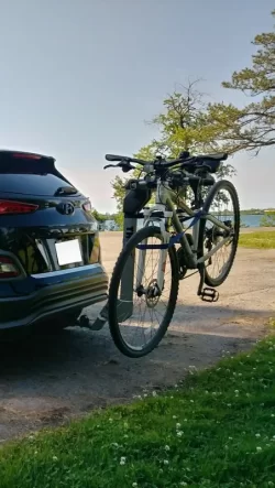

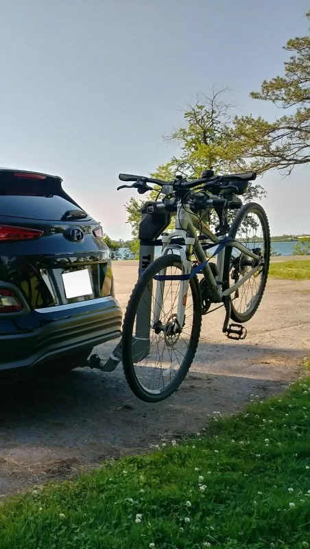

To those of you who've installed trailer hitches for bike racks: I've noticed that the Curt 11529 installation instructions specify that loads not supported by wheels -- ie bike racks -- must use stabilizing straps (top of page 5). Did you do anything about that, or do you think it's safe to ignore?
Stabilizing strap, I use the ratchet straps when I go on the highway. Otherwise within the city,I just use a bungee cord to keep the front wheel from moving too much. Installed: Curt #11529 . Thule Helium Aero bike carrier to cut weight down.

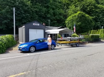

I have 2 different Triton aluminum trailers that I use behind my 2017 Volt. One is a utility trailer that I carry stuff to the recycle center and the other
is a small "sport" trailer that I carry max of 2 kayaks and 2 paddleboards. I see about a 20% reduction in mpg and my guess is that it is mostly from
rolling resistance and wind resistance. I don't think the vehicle is being stressed and I would hope that any of the Hyundai/Kia EV's should be able to safely
handle this type of use.

I have the Curt 11529 hitch as well. I don’t bother using ratchet straps on my bike rack (just the anti-rattle locking bolt) and it works fine. I also use the Curt 18145 cargo carrier which does a great job of hauling around extra gear without much of a hit on mileage.

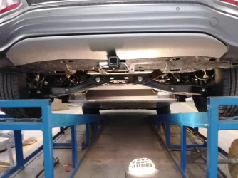

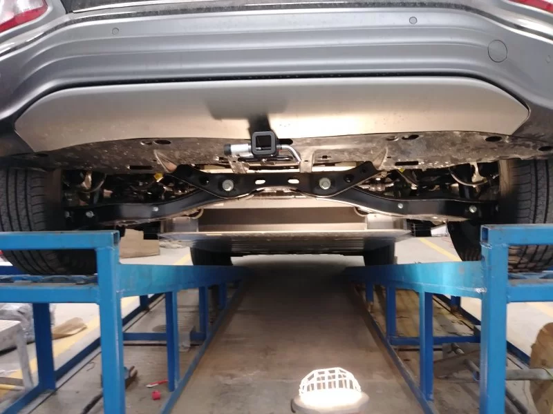

CONFIRMED!
Curt 115201 fits the Kona Electric
