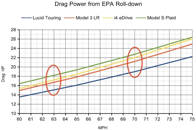

This is a deep dive into EPA mileage and range versus user 70 mph benchmarks. One problem being EV makers can use either a two or five test metric where the two test method gets an 'engineering factor' adjustment. But all vehicles have a set of 'roll down' coefficients that map to the drag force and subsequent power needed to sustain a given velocity. For example:
  • 63 mph - earlier Prius benchmarks derived the EPA mileage
  • The four vehicle, drag power at:
    • 63 mph (EPA) and 70 mph (user) percentage (EPA/user)
    • 15.0 hp 19.0 hp 79.2% - Lucid Touring
    • 16.7 hp 21.2 hp 78.6% - Model 3 LR AWD
    • 17.2 hp 22.0 hp 78.0% - i4 eDrive
    • 18.2 hp 22.7 hp 79.9% - Model S Plaid
  • Many truck companies limit highway speed to 65 mph
    • following, not tailgating, minimizes your being tailgated
    • some risk of rock and slush impacting vehicle
    • very efficient cross country practice using dynamic cruise control
The EPA listed MPGe can be either a two or five test average which introduces an unnecessary variation. I would prefer to see the five test as the standard because it includes weather extremes. Regardless, the roll down coefficients can calculate the 'drag power' needed at +20 mph speeds. Notice the 70 mph metrics will be about 79% of the five test, EPA listed metrics.

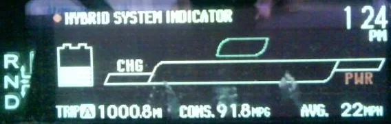

ps. A single tank, 2010 Prius benchmark from 2013:

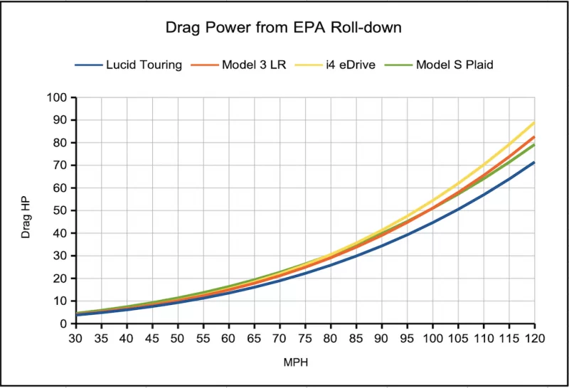

Here is an example chart:
  • Lucid has excellent low drag at low and high speeds
  • Model 3 has higher drag at lower speeds - tires
  • Model 3 has better drag than Plaid at high speeds
Based on this chart, I would look at lighter weight and narrower tires for the Model 3. Better tires would make the Model 3 more efficient in kWh per mile.
I've embedded the OpenOffice spreadsheet in an attached ZIP file. If you have questions, let me know and we can tweak the chart for other vehicles and details. For example, I would set the X-axis scale to 60-70 mph and the Y-axis scale to expand the HP details. Prius experience has shown EPA metrics can be achieved by holding 63 mph on a benchmark loop.

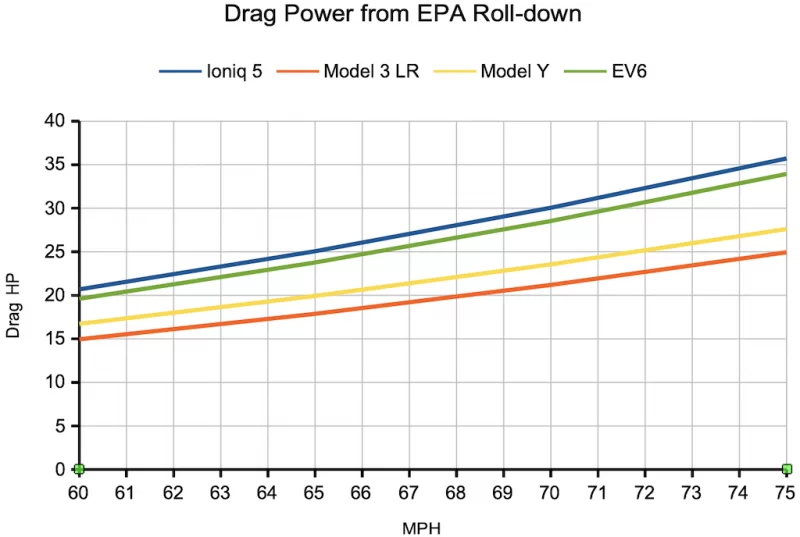

I'm would be curious to see the Kia EV6 and Hyundai Ioniq 5 compared, along with maybe the Tesla Model Y. We're going to do a 70-mph range test with Ioniq 5 soon, and judging from posts I see about it in various groups, I suspect its aero Cd really affects it at higher speeds.
Drag power at 70 mph:
  • 30.1 hp - Ioniq5
  • 21.2 hp - Model 3 LR
  • 23.6 hp - Model Y
  • 28.5 hp - EV6
GOOD LUCK!
  • 30.1 hp - Ioniq5
  • 23.6 hp - Model Y
  • 28.5 hp - EV6
GOOD LUCK!
That's amazing and, I think, a pretty informative snapshot.
Kyle just did a 70-mph test on Ioniq 5 AWD, and as you can imagine by looking at your graph, the results weren't great. (I don't think he's released the number yet, but we'll talk about it on the Podcast this Friday.)
FYI, I can modify the graphs to show kWh/mi (or kWh/km) as a function of speed. By hand, one HP is 746 W.
For my Model 3, I've plotted range as a function of speed using the battery kWh. I needed this when dealing with the earlier, less dense SuperCharger network. Addition of two SuperChargers in Arkansas and relocation of the Joplin SuperChargers has made trips to Coffeyville KS trivial.
So, the Ioniq 5, then, would take (30 X 746 Wh) 22.38 kW to travel at 70 mph?
Correct:
  • in one hour, 22.38 kWh
  • 320 Wh/mi ~= 22.38 kWh / 70 mi
  • 3.13 mi/kWh ~= 70 mi / 22.38 kWh
This is the drag power and does not include battery, inverter, and motor losses. The ratio between this and the benchmark gives a first approximation of the drivetrain efficiency.
