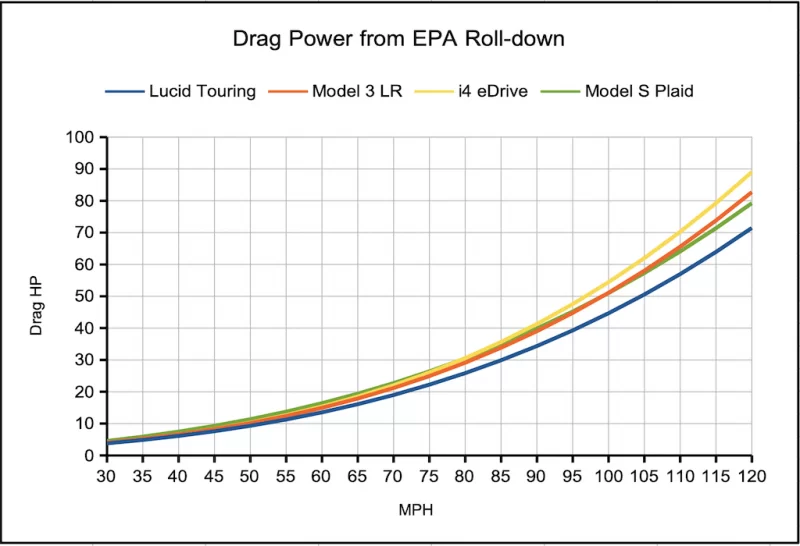

I appreciate the ‘Lucid range’ podcast not because of the car but your team discussion of ‘70 mph’ testing.
My +10 years of Prius testing revealed ~63 mph within a Standard Day comes closest to achieving EPA metrics. But I also appreciate using 70 mph for the reasons you discussed.
Perhaps a little too abstract, I like to use the EPA roll down metrics to model the total vehicle drag power required at different speeds. This lets me see the efficiency of the drivetrains. But then I’m a retired (aka unemployable) engineer.

Is this the coastdown data you look at, Bob?
I’m on iPhone and will check later. Here is the URL where I download the data:
https://www.epa.gov/compliance-and-fuel-economy-data/data-cars-used-testing-fuel-economy
There is a quadriplegic formula to convert to the drag force. Then you can plot the drag power as a function of speed. This is great for comparing vehicles.
As you point out, manufacturers can do the 2 or 5 test and afterwards ‘sandbag’ a worse mileage number. But the roll down coefficients are consistent for all vehicles.

I went to this page and opened up the 2022 spreadsheet. Was interesting to see some models not yet listed on fueleconomy.gov, but couldn't figure out any useful data aside from horsepower numbers.
Check columns:
  • BC - Target Coef A (lbf)
  • BD - Target Coef B (lbf/mph)
  • BE - Target Coef C (lbf/mph**2)
The formula for HP:
HP = v * (A + B*v + C*(v*v)) / 375
745 W = 1 hp​
Create a spreadsheet with a column of mph from 10 mph to your desired max mph in whatever increments you want. Then setup a column for each vehicle using separate columns of the coefficients. Load the cells and do a scatter plot where speed is the X-axis and resulting HP or kW is the Y-axis.
ENJOY!

Thanks, Bob!
Just sharing some 'lessons learned':
  • Typically 3-4 vehicle graphs work as any more becomes confusing.
  • Use 3-4 columns on the left to hold on each row: vehicle name, Coef A, Coef B, and Coef C
  • The next MPH column works best starting around 10-15 mph with a 5 mph increment going down the row
  • Each vehicle column uses the "name" and "coefficient" values in a source column
  • Cut-and-paste for vehicle columns makes it trivial to generate the vehicle values
  • Select columns for a 'scatter' graph showing the vehicles
Would you like an OpenOffice, spreadsheet example?
  • 2019 Tesla Model 3, Tesla Plaid, Lucid Air, and Ford Mach-E

Just a screenshot would be fine, since my math capabilities are somewhat below engineer level. :)
Here is an example chart:
  • Lucid has excellent low drag at low and high speeds
  • Model 3 has higher drag at lower speeds - tires
  • Model 3 has better drag than Plaid at high speeds
Based on this chart, I would look at lighter weight and narrower tires for the Model 3. Better tires would make the Model 3 more efficient in kWh per mile.
I've embedded the OpenOffice spreadsheet in an attached ZIP file. If you have questions, let me know and we can tweak the chart for other vehicles and details. For example, I would set the X-axis scale to 60-70 mph and the Y-axis scale to expand the HP details. Prius experience has shown EPA metrics can be achieved by holding 63 mph on a benchmark loop.
