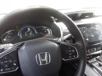

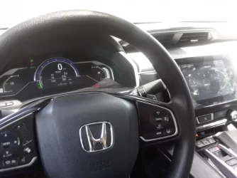

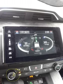

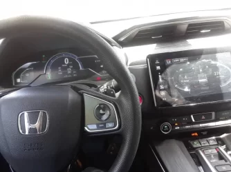

Ok. Here's a picture with auto ac engaged, the car in park, this time 5 miles of ev on the battery, and evidence that neither HV nor HV charged is engaged.
After merely 10 minutes in park, the ICE fired up for approximately 3 minutes.
