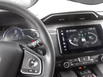

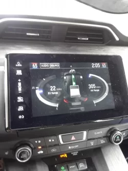

Here are pics of the phenomenon:
Wow, in ECON and Park with 90% SOC and the engine is running. Didn’t think that was possible but you’ve got the proof.
Only thing that comes to mind is
1. What is the red warning in the DDI in the second pix?
2. The power meter is all white with no blue at all. The only time I’ve seen that on mine is when it did a System Check. I wonder if that’s what it was doing. Only way to know is if it doesn’t do it in the future. Otherwise I’m stumped as to why yours is seemingly acting differently from the rest of ours.
Reverse engineering this wiz-bang computer on wheels masquerading as an EV is quite a challenge.
Not to be argumentative because Geor99 is adamant the car wasn't in HV mode, but the pictures aren't conclusive either way. I only have 6 weeks with my Clarity, so I may be confused, but you can be in HV and Econ at the same time. I think the only way in the pictures to know if the car was in HV or not would be to be able to see the far left of the display above the steering wheel. I think Ray B's hypothesis makes sense, but only if the car was in HV.
And if the car was unknowingly put in HV mode ... set lunch on the button for a moment for example ... HV would disengage when the car was turned off and go back to just Econ for the next drive, so it would be hard to tell after the fact.

That's just the brake light. I use the emergency brake when parked.
I said that it didn't happen yesterday. It did happen today.
And no, I don't sit in my car with the A.C. running for an hour everyday. Im trying to get the IRS on the phone and my office walls are thin. So, I sit on hold waiting for them to pick up in the privacy of my car.
I promise you it's not in HV charge mode. Im absolutely positive that it's not.
